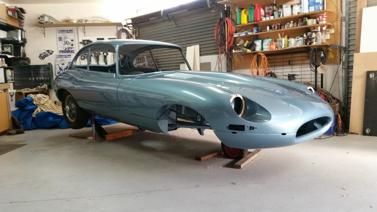

Hi to everyone here, firstly may i thank you in advance for any assistance that may be provided by members on this forum. After a lengthy hiatus i am continuing the restoration on my 68 FHC 2+2. I purchased this car completely stripped with all parts in boxes etc [ not a single bolt attached to the car !! ] as you can imagine it is not an easy task to re-assemble when you haven't removed these parts in the first place and having never restored a car before, let alone an e-type !! I have noticed over the years previous that some people have made extensive reports on their own restoration projects and although i have many copies of the these books etc there is always many little things that are not documented or photographed. I would like to ask is there any of these documented on this forum that anyone can recommend as a good reference point for me to use that would be closely related to my e-type [ may 1968 ] Many thanks in advance Paul

Pretty car! If there’s anything I can photograph to help, just shout!
