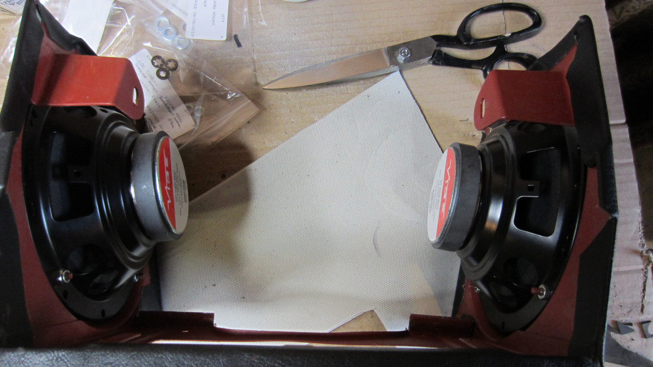

I dont know if the 74 has the same space problems as the Series One, but if it has, it is quite difficult to fit a standard sized radio in with more modern speakers.
I fitted a Retrosound radio, which has a much smaller body and therefore more room for the speakers, but still looks classic.
https://www.raysmith.co.uk/retro-car-au ... bble-black
