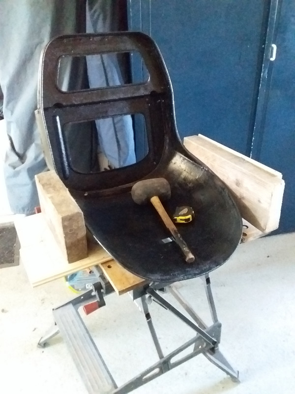

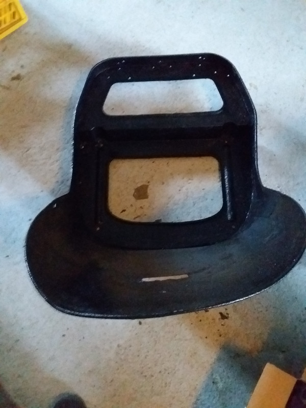

This is Santokh Maan, who is still busy restoring a RHD 3.8 S1 DHC 1962 #850373. I acquired it with most body fittings ripped out. Have over the years collected most bits and am right now "modifying" one seat.
One is from a DHC and the other from a FHC, (did not notice the difference when picking them up). Identical dimensions but different backrest curves. The curve is asymmetrical. I can assume they would want occupants to slightly turn their bodies towards the centre line. Or is the other way around? Depends on the couple's relationship? Can I go ahead and modify the FHC seat to a mirror copy anyway?
Or are the DHC backrests symmetrical? That would leave me with two seats to modify, of course.
Next step is to make the wood set for the upholstery. Would appreciate suggestions here.
Please see photos and let me know if I am going insane. And which way you think occupants should face.
Santokh

On the assumption that you are showing us two seats in the photos , I think both your seats are from a FHC. The DHC - more accurately described as Open Top Sports - seats are much narrower at the top, with quite a distinctive pointed shape. If contrary to the photos you do have an OTS seat, then I think it will be very difficult to make it match without creating a complete new backrest

Thank you. I was afraid of that.
I see pictures of OTS seats on http://www.monocoque-metalworks.com/mai ... r-of-love/ with triangular cutouts.
Need to get my hands on an old bare genuine OTS seat, before proceeding to bash them further.
Did these seats need wood sets for upholstery?
I apologise for asking such basic questions.

Monocoque Metalworks in the US manufactures both types of seats. If you contact Chuck I am sure that he would be able to supply you with a patch panel for each of your seats. Other people to ask would be Hutsons and Martin Robey in the UK.
