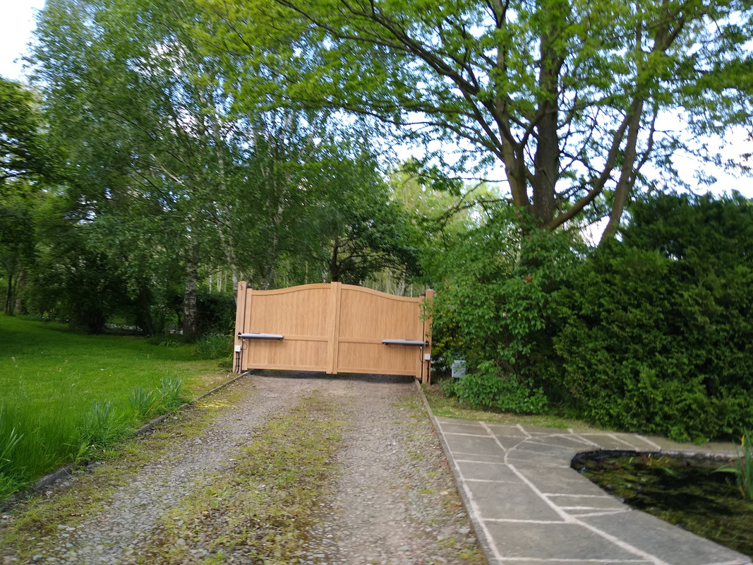

I thought I would follow up with a conclusion on this to let you all know that I did follow at least some of the advice provided.
We placed our order in early April and the install was just completed on Friday so a bit of a wait but worth it.
We went for 3.5 metre wide aluminium swing gates with a faux oak finish and they look very convincing. We took the forum's consensus and went for 24V automation actuators. They don't look particularly attractive but I think they're just about acceptable.
Actuators and GSM intercom are Came (Italian) and it all works great. The guys who installed it were superb, the only problem being delays due to the weather.
Next step is to get the drive sorted - work begins mid July.
Thanks for all advice.
