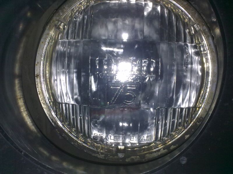

Anyone else remember 75watt sealed beam units?
Not only remember them but still have them fitted to my Rover P6.
Bob
