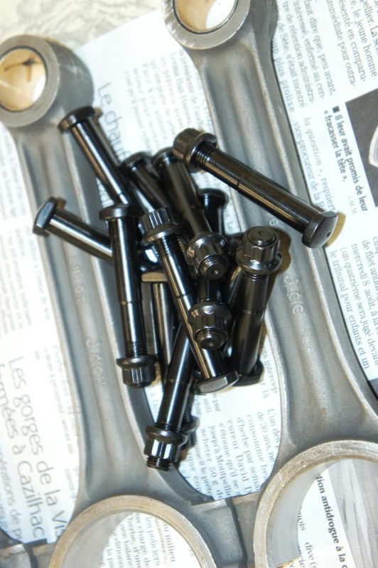

Indeed, yes, this is what my "missing" new set of bolts looks like now it has turned up.
No apology or regrets.

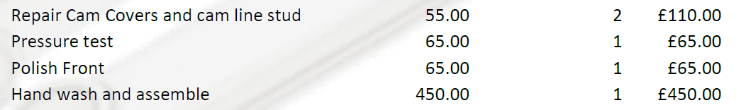

This was the relevant section of the invoice :

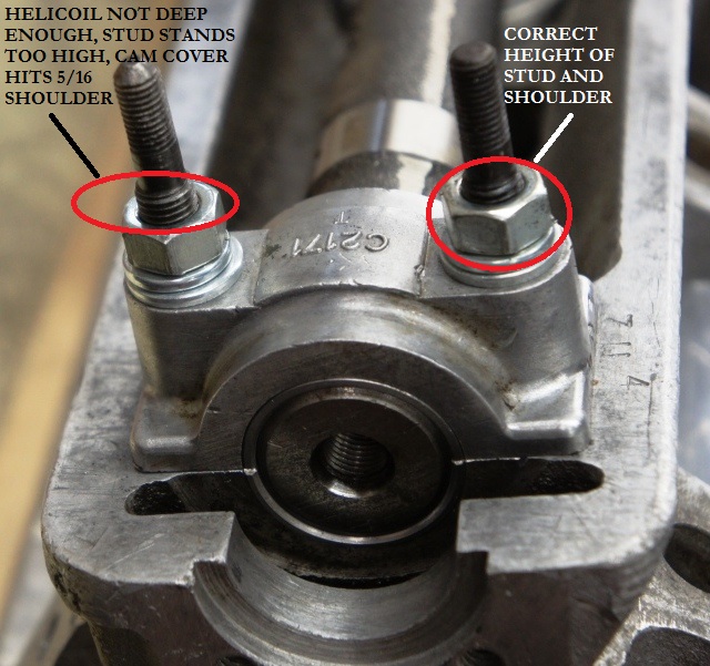

The cam-cover would not sit over the studs correctly, as one of the studs sat too high, so the 5/16" shoulder was stopping the cover from seating.
So, having paid £450 plus VAT for the assembly of a head that was "ready-to-fit", it was time to strip the caps off and get the cams out.
(I used to do this for a living, and have the kit and the know-how - but how does the disappointed enthusiast in his lock-up, and with his Halfords tool-kit, cope ?)

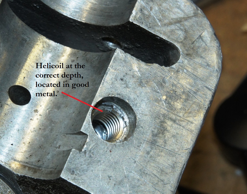

It turns out that one of the cam-post Helicoils is not threaded deep enough into the head, so the stud is effectively too long.
This is what a correct-depth Helicoil should look like.
Then I noticed that the very Helicoil I had specifically mentioned on the job-sheet as being too deep, and needing replacement, had not been touched at all ................

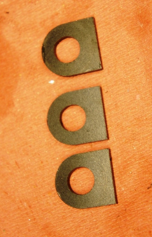

It then occurred to me that the cam-caps used to have hardened steel D-washers like these
fitted, but that my engine had been rebuilt with just ordinary bright zinc washers ........... the old D-ones were effectively thrown in the box of junk-parts that came back with the rest.
Why ?
