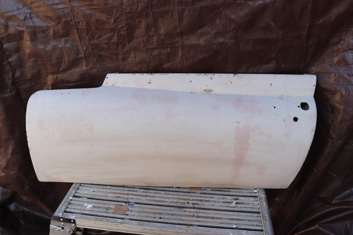

A friend of a friend has a pair E-type doors in his garage but has no idea what they came off because they came from a garage clearance he did some years back.
The doors have no handles or winders so how can they be identified?

#3 Re: E-type doors
Post by lee-type » Sun Oct 28, 2018 1:00 pm
Good afternoon guys
Here are some photos. the doors measure 39 1/4 along the bottom of the door. Am i right that the DHC and OTS doors are the same and the 2+2 doors are longer?

#4 Re: E-type doors
Post by mgcjag » Sun Oct 28, 2018 2:22 pm
At 39in they are 2+2 doors....you can see the holes at the top of the door where the 2+2 chrome trim fits...you also have a seperate hole for a door lock....think this was on the 1.5 model......Steve
