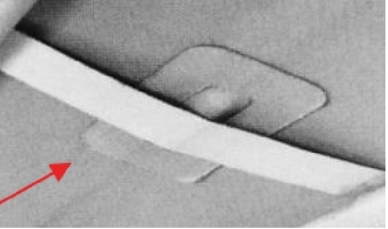

It was in that thread but this may make it clearer:
S2 lead bag:

Hi David,
Thank you for the reply, it is easy for me but I am slightly confused 🤨
Is the lead weights sewn into the hood behind that square patch? Or does the long 5/8” sausage shaped weight shown in the earlier picture fit through it?

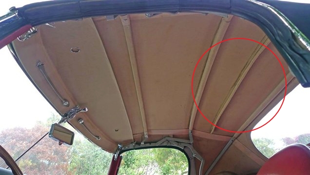

The long sausage lead bag is only for the S1 hood which is different to the S2 hood:
S1 with three bows (red circle shows location of the long lead bag):
The S2 has the rectangular patch glued to the hood with the lead weight in the blob:
S2 with two bows:
You will also see that the S1 hood 'sticks' are different. The S1 has three bows (extra one in the middle) whilst the S2 only has two.

Paul Jorgensen
