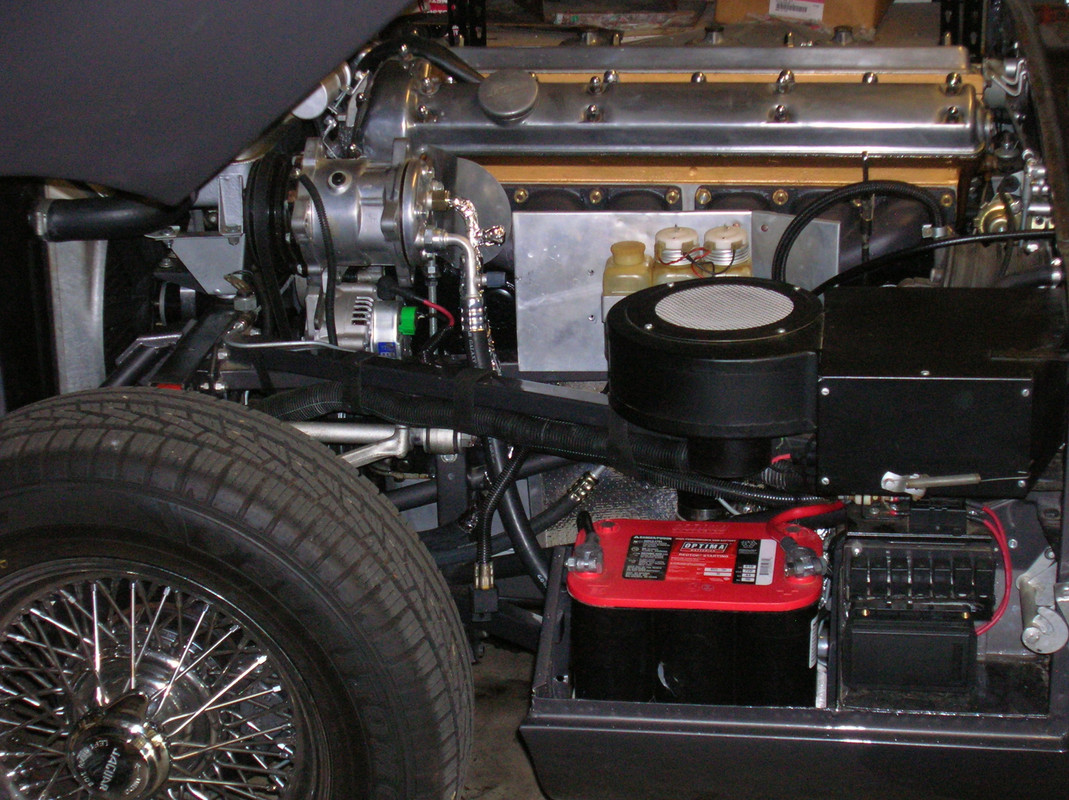

If you want a robust electrical system for the long term you might overlay the "Bob Skelly" redesign over the original system. It adds multiple relays and new fuse panels (in most cases superseding the originals). My expansion of his design philosophy is depicted in the photo below. At the top of the "stack" are two 40 amp fuses...one for switched (by the key), and one for un-switched (hot) circuits. Multiple relays are on the second tier, a large fuse panel is at the bottom. A second, smaller panel resides behind the false back of the glove box. The original wiring looms are unmodified. Some wires were re-purposed. A number of new load carrying wires were added. Panel switches (including the ignition switch) now control relays rather than carry component loads. A plastic loom cover protects the new fabric enclosed loom from SNG. It's all completely reversible.
