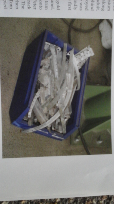

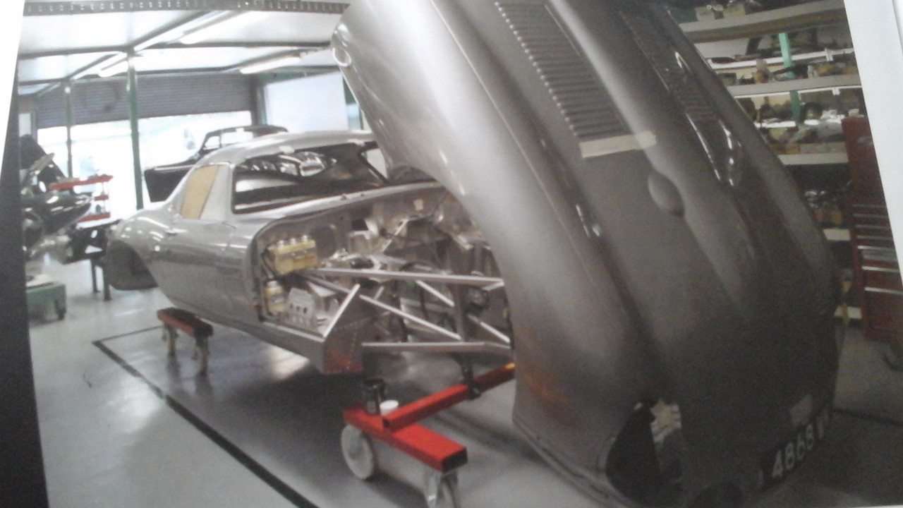

Post by mgcjag » Sat Dec 22, 2018 9:05 am
A couple of bulkhead photos and the box of bits that was the only unused original metal not used....Steve

#10 Re: Lindner Nocker Low Drag Pictures.....Help Please
Post by E600 » Sat Dec 22, 2018 4:18 pm
Thank you all for your input, especially the bulkhead photos. Interesting to see all 3 fluid reservoirs the same size and venting into a 4th

The material is NS4, not readily available these days. Until very recently NS3 (IIRC) has been used in all quality alloy bodies copying the LWE theme. Until the 6, or is it 7, or even 8😏😏, new bodies by Jaguar which I believe stuck out for NS4.
NS4 does not like to be worked too hard and is prone to cracking, hence the many strengthening panels applied in period to the most active cars. It is widely viewed by the experts (me not being one of them) that the Linder car will now always be very susseptable to stress cracking because of the measures taken to reshape the structural panels, not much option given the state of it!
RS Panels painted the car for CMC and I understand made one exact copy (initially planned to be more than 1) seen about as 70 WK.
As for bulkhead detail, quite a few differences from a "STD" LWE, due to the slide throttle and over the frame exhaust. All LWE's have the overflow 4th reservoir bottle.
