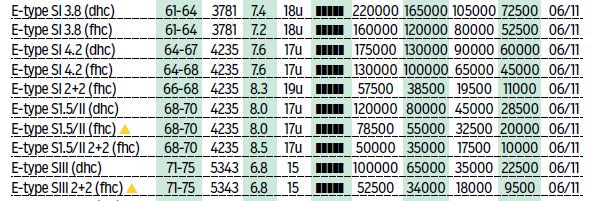

Post by vikla » Thu Jan 03, 2019 5:53 pm
There is another free resource for classic cars prices - the Practical Classics price guide which is updated regularly.
The last one I downloaded was for August 2018 - details below
These are the price categories
What I often see when people are advertising privately is putting the car on at a 'dealer' price which is completely unrealistic. I reckon dealers, depending on their E-type expertise and knowledge, will often achieve at least 20% more than selling privately.

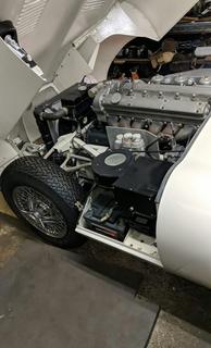

Post by Pbirty » Thu Jan 03, 2019 8:01 pm
Hello. Thanks for your comments and advice.
Think I have managed to upload some pictures. I have done a little more work on the car since some of these were taken. Its currently in a carcoon for the winter. The car has undergone a full restoration but did start out as a rust and rot free example so little to no welding has been done. I have tried to keep the car as original as possible retaining the correct colour inside and out. The rebuild included a full engine and gearbox rebuild along with the rear diff and all running gear. There are a few more jobs I will get done when it warms up a bit. I'm a little unsure if getting the car registered on Uk plates will be a good or bad thing. Will it put another owner on the car? and will this affect its value in any way? I have done some research and think its only a 4 owner car. Im going to get the car detailed at some point soon as the engine bay is full of dust. Cheers Paul.

#17 Re: Valuation.
Post by mgcjag » Thu Jan 03, 2019 8:18 pm
You need to get a Heritage certificate and have it registered to give it a full identity......its value will be decreased without it....Steve

#18 Re: Valuation.
Post by nefematic » Thu Jan 03, 2019 10:23 pm
...Will it put another owner on the car? and will this affect its value in any way?...
If it was me buying your car I would pay a premium for it knowing you had it registered and driven it for 2000 miles and taken care of anything not just right after assembly (that could be a many of small things you find out whilst test driving). You are the fifth owner? So what difference would it make if it were registered before the sale? It still remains a five owner car nonetheless. Register and drive it. It makes for a more authentic seller.
