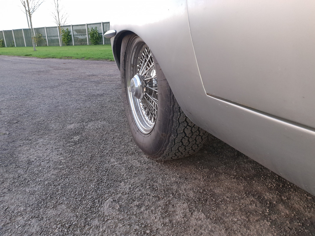

Posts: 1017
Location: Boston UK
#18 Re: Buying MWS wheels
Post by politeperson » Mon Jan 21, 2019 8:35 pm
Mike,
Loving those competition wheels, your car looks great I must say.
Mark your car looks great as well!, When are you back in the UK?
Carsten, why are 6.5 inch wheels too wide? Look at Julians (below). They look like MWS 5721s to me.
MInd you, I like all of them!
James
