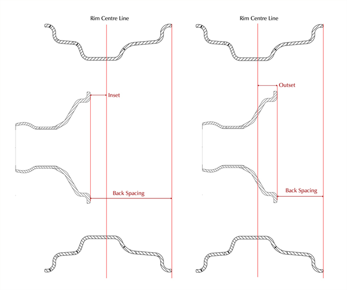

Carsten....from MWS site..this explains inset/outset/backspace

Hi Steve,
I have seen this, and I understand the principle. It is called „Einpresstiefe“ (depth of being pressed into...) in german.
Now, what I do not know but it seems I have to know is which value is ok for my car ? Which depth is optimal and will not rub ?
Limora said in the online help chat that the 6.35mm offset variant, being the most expensive btw, will work.
But how can I be sure ? And what about the 3.2 mm and the 8 mm version, who needs those, then, and why are they cheaper ?
Carsten

If you want to keep the bump stops, then a wheel with the standard (ie 97mm) backspacing should be ok;
eg XW5778 / 6x15: with that wheel the outer rim moves 1 inch to the outside (track is also widened by 1 inch/ 25mm).
With the wheel you mentioned (XW5745 / 6x15) you have even 2mm less backspacing, so should be no problem there (track + 29mm).

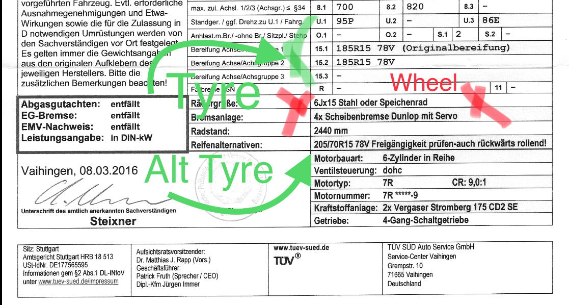

in preparation for Tuev, have you aquired a Datenblatt yet? They definitely have a say on the tyre dimension, they may decide to put on a dimension for the wheels as well. What I want to say is up front I would talk the wheel set through with your local Tuev-Ingenieur doing the road test, and the historical sign-off, before commiting to a specific wheel.

here an excerpt of my Datenblatt showing tyre dimensions demanded, with wheels being either steel or spokes, 6x15. They show an alternate tyre size 205/70R15 78V, these will be checked for free spinning, also in reverse. They did check my my tires, I have Michelin XVS. I believe my rims to be original, they never questioned me on those. If brand new, and thus obviously aftermarket, they might feel inclined to ask for documentation supporting the legal use on your E. My guess would be the‘re going to blinded by all the bling of your shiny chrome and totally forget all this - you just never really know up front. If you want a copy of my Datenblatt give me note with your email address.
As a side note, mine is a US import, they also have the data down on CR, Strombergs and 4 gear transmission. Chang something (e.g. Strombergs to SU‘s) and you lose your privilige to the historic status - thus higher tax and insurance.
