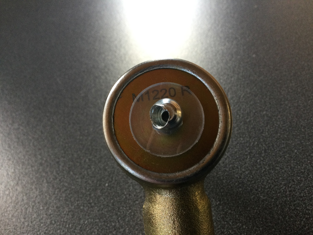

Just received a pair of Track Rod Ends (C25447U). The quality of the main component is excellent but as for the grease nipple which I have shown in the photograph is appalling quality.It has hardly any thread in the body of the nipple and it just pulled out. This is only a minor point but it needs to be addressed.

Thank you Steve. I have emailed SNG which I hope they will take note. The new track rod ends have 6mm threaded grease nipples and Sod’s law I have a box of imperial sizes. My post was only to highlight the facts. I’ll be happy if they send me a new nipple.

In response to this issue above, we have taken a look and we think that the issue raised is as a result of damage at some point rather than a design fault. Our technician advises as follows:Fuel.inj wrote: ↑Sat Jan 23, 2021 12:52 pmJust received a pair of Track Rod Ends (C25447U). The quality of the main component is excellent but as for the grease nipple which I have shown in the photograph is appalling quality.It has hardly any thread in the body of the nipple and it just pulled out. This is only a minor point but it needs to be addressed.
Because the transit boxes have minimal padding, if they are dropped, the head of the nipple take the full force of the impact.
I think that is what has happened to the one on the forum. It splits the body of the nipple and strips out the thread.
So, we are going to check all stocks and repack with additional measures. I dont know if the customer service team have resolved the issue above (i cant always work out who the customer is from the forum handle) so do please contact them to arrange replacement if not already done so.

Thank you Julian. I have had replacements and your sales team were first class in responding to my email.
You state that it’s probably been dropped on the point of the grease nipple but on close inspection there is minimal thread cut which has caused the issue. Regards, Paul.

Just to update on this one, we concur with the above and will make a revised version available in the coming months in the next batch that takes into account the changes. Thanks for the input.
