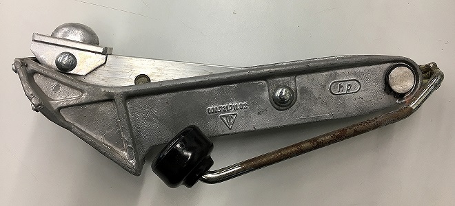

This car is very sound but i have been frankly scared to use the factory jacking point due to all the horror stories i have read here and other sites on sill jacking.
Have made a wooden block for stabilization more than anything. Don’t need additional height. If i could crank the jack up more it would be more than adequate far short of full extension.
Confirming this is the same jack as you are using?

I believe i understand what you are saying about jack function. The mechanical advantage increases as you raise the jack. More turns of the lead screw are required for an inch of lift, so as the full weight of the lift is placed on the jack it remains “easy” to operate.
Not experiencing that. It gets harder to operate as it rises and lifts the weight of the car. I placed the jack front and center on my sprite. I lifted it but it did get harder as the weight was increased on the jack as it lifted and became rather difficult as it took full weight of the front end.
Also, grabbed my balls and jacked the car at the sill factory jacking point. Lifted better than at the radius arm body mount bolt but very difficult to get rear tire off ground. Rear came off and it was too difficult to continue to crank in order to get front wheel off ground. I was on my knees turning as hard as i could.
(To be clear with no weight on the jack it operates smoothly throughout the range.)
So what do others experience with this jack at the factory sill point or other locations?? So far all I see is theory. What’s the reality of a lift.

Hi layne..cant get to my E at the moment its a 2+2 and i dont use the Porsche jack on it...however....not exactly what your asking..but i have a 900kg Porsche jack but with a different top mount...just jacked up both side wheels off the ground on my 4x4 from the front jack point.....had to put a fair bit of effort in but i have a short handle..Steve

STeve, thats the same jack i have but with the top lug. Unlike you, i have a long “crank” and it’s still very hard with full weight on it ( smilely face here but i cant add emojis). Good example.
Ralph, at what points on the E do you lift?
I may take a look at that one.
Doesn’t seem like others have a problem with my jack but it seems to be in perfect shape and I hate to buy another and have the same result.

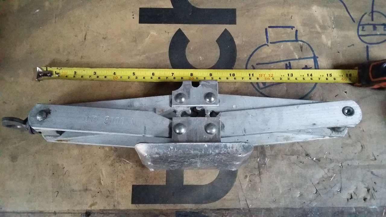

Layne, I’ve just bought a 944 jack and lifting at the jacking lug it easily got the car to height to remove the wheels. The max height of the jack is the same as yours.
If you’re concerned about lifting at the sills why not do what I did and used a load spreading piece of wood. It is the same thickness as the lifting point of the jack so it didn’t increase effective the height.
And the higher the jack got the easier it seemed to be to operate it.

Wow, jusr the opposite for me. The higher the jack got when lifting the car the more difficulty in turning the crank, got VERY difficult.
BTW, i did lift at the sill jacking point with no ill effects, see my ealier post for results.
