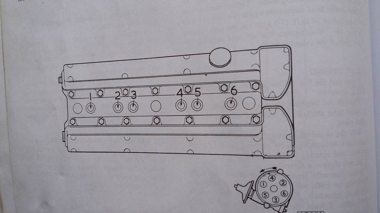

Hi Paul....just for info...do not sit the head on a flat surface....if you look underneath you will see that valves protrude below the base of the head so they could bend is sat on a flat surface.....also check your head now befor you start that both cams are at tdc....DO NOT.try to turn one or both cams as valves could clash and this could cause damage.......ask any questions here...Steve

Hi Paul....with the head off you can see the pistons move as you turn the crankshaft ....piston 6 (front) &1(rear) move up and down together.....the crankshaft turns twice for one turn of the distributor....so for TDC on piston 6 turn the crankshaft until the rotor arm in the distributor is pointing to number 6 as in the digram and the front piston it at the top....look at the crankshaft pulley for the tdc mark.......the pointer may not line up exactly as its adjustable......true tdc is half way between when the piston stops and when it starts to move again....you will need a dial guage for this.....at this point the pointer can be adjusted to the tdc mark......lots of info on line to explain or help you....Steve
