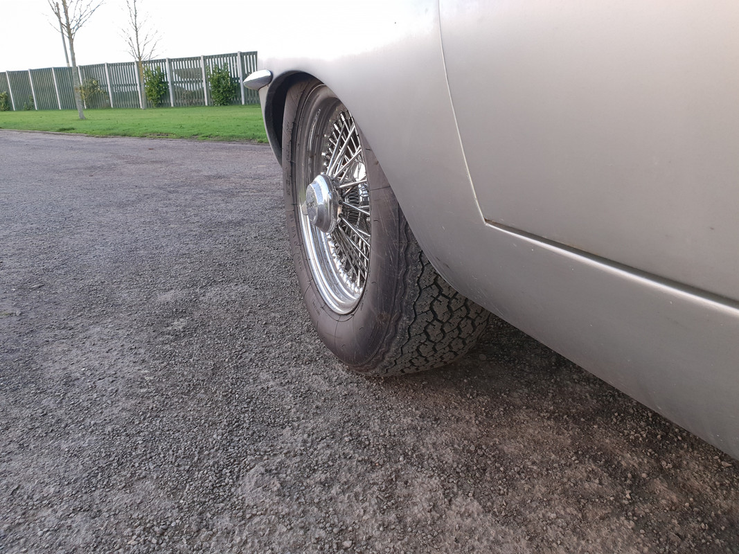

Post by bobsnicholson » Sat Sep 28, 2019 10:12 am
Quick clean.
Underbody is fine for now.
