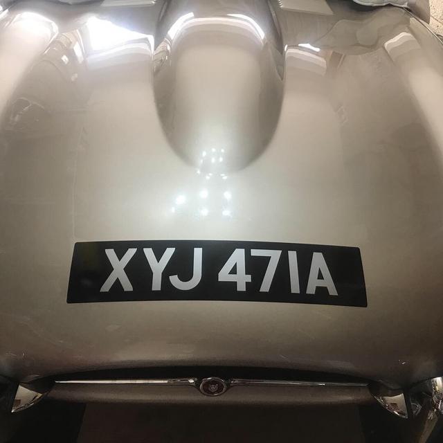

A question regarding the stick on front number plate.were they white on black or silver on black.the tear plate is raise silver on black.

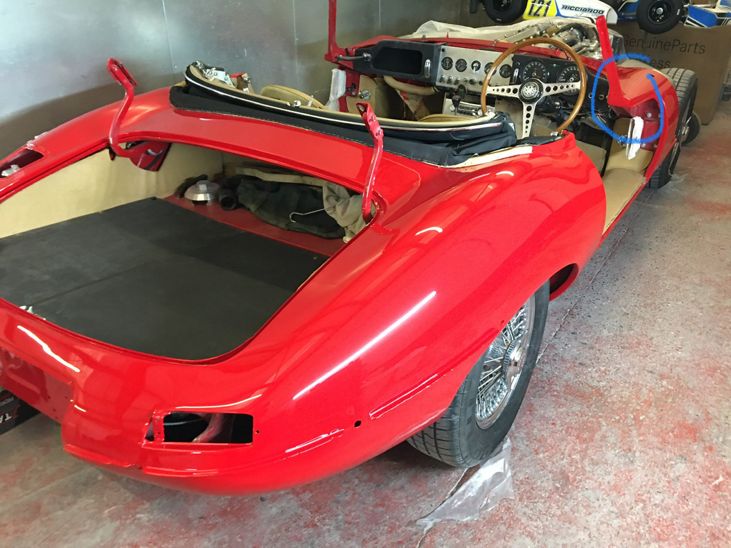

If you look at the area marked in blue pencil, I believe there should be a hole to take a rubber block attached to the A post door seal, Is this correct as mine has either been filled in or does not exist. Can anyone enlighten me.

Anyone know the answers to my questions regarding the stick on front number plate colour. Ie, White on black or silver on black and if there should be a hole to take the door post rubber as circled in the picture above in blue.

Tony : I don't think there is a correct answer to the number plate . I have seen both silver and white used. The white gives more contrast, and the silver is softer
As far as your door jamb is concerned, I've just been to look at my cars, and the whole area is covered by the door seal which is glued to the screen pillar and then forwards and then round the entire curvature of the bulkhead. It is quite thick at the base of the pillar, to provide a buffer. You are welcome to look at mine - I shall be around most of this week

Search on the forum there’s stuff on numberplates
I went for white on black
Tippers do the “period” 3.5 inch sized characters cut specially which is perfect
Other companies do a more modern digital style
Really good service from tippersvintageplates.com
I emailed Josh..v helpful
Robbie
Posts: 1221
#20 Re: Front wing part panel. 62 series 1 e Type convert
Post by rswaffie » Sun Dec 15, 2019 12:43 pm
As per previous replies, I went for silver on black from Tippers for my ‘63. They can advise if there are specific specs for your model year.
My shut panels did have triangular ‘indentations’ to allow the ‘blocks’ in the seals to locate. However, I still had to trim the blocks to get a good fit.
