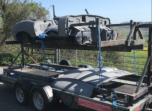

I am at the stage in my FHC body-off restoration where I need to take the roof panel/rear-end assembly somewhere to get it sympathetically sandblasted. The roof panel itself is good but everything else needs blasting. Any recommendations please?

Mark. I went through sandblasting my shell a couple of years ago and was lucky enough to find a commercial blaster who was also a car guy. He assigned an experienced employee to the job and blasted all the difficult to reach areas for me. He outright refused to blast any large exterior panels. I would suggest you specify the same treatment. Large flat panels are easy to strip mechanically or with stripper. Do them first so that as soon as you get back the shell you can put a coat of epoxy primer on it to stop rusting. Consider doing your suspension parts and frames at the same time but make sure they are degreased first. Good luck.
