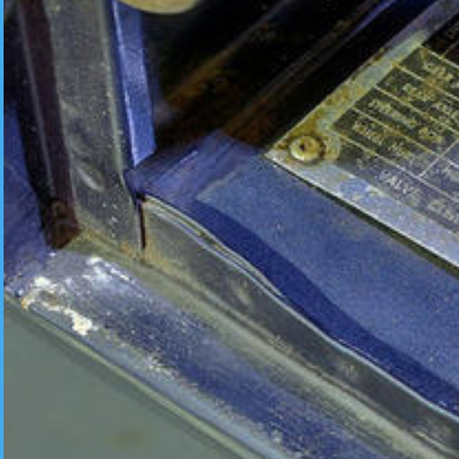

Looking at the bonnet shutlines, in the photos on the driveway the R/H sill to bonnet gap is too big but in other photos it looks pretty good - I wonder if the bonnet was not fully closed when the photo was taken.

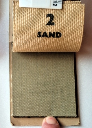

Hood is the wrong colour, the green car behind has a French Grey colour hood.

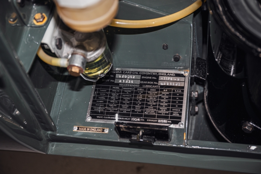

Just by the way...what colour should the bracket for the clutch/break reservoir bottles be?
The one here looks like dove grey possibly
My original one(March ‘62) has black paint
Robbie

French Grey hood - as someone trying to source this colour it appears it is not available!

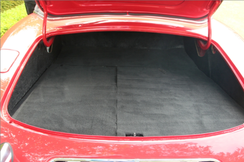

This car is not original. Its been recently altered to make it look like an early car with alterations to the Boot hinges. Previously it wore later style hinges when it was a Red car. and the boot drain outlet is as per later cars being on the side.
And now the car has been recreated to appear to be an early car with the early single boot lid hinge and the boot lid drain in the centre of the car. Fuel tank is a later replacement.
Fuel filler cap cover previously later production..
Certainly not an early original car. Caveat emptor..

Correct - Single hinges were used until about June 1961 #875100 (875100 Dual, 875103 Single, 875115 Dual) and Dual until about September 1961 #875778 with the thick single cast used from #875779 onward. So this car would have had dual at the Factory which were changed to single solid during an earlier restoration/rebody and then incorrectly put back to single hinges.splosh wrote: ↑Tue Jul 14, 2020 12:17 pmThis car is not original. Its been recently altered to make it look like an early car with alterations to the Boot hinges. Previously it wore later style hinges when it was a Red car. and the boot drain outlet is as per later cars being on the side. And now the car has been recreated to appear to be an early car with the early single boot lid hinge and the boot lid drain in the centre of the car.
Does that mean it was not featured in the July 'Famous 56' Factory photograph?Ian Howe wrote: ↑Tue Jul 14, 2020 5:04 amIn terms of 'early features' it is important to reference the body number. The first 25ish RHD cars were produced quickly then there was a gap in RHD production for LHD. This 'early' RHD car has body number R1236 which equates to a LHD car with a VIN in the region of 875150 - quite late in terms of some early features that changed rapidly (in body number sequence) during initial production.
From the official blurb: "Much like many of its sister cars, #62 had over the years lost some of its distinguishing early features, which had partly helped to hide the significance of this car. The car most importantly retains its original matching numbers body (although naturally a number of panels had been replaced) and engine - including matching cylinder head - as well as the original Moss gearbox."
I understand it had a scalloped rear bulkhead and a later bonnet in 2016 - so yes Barrie, probably re-bodied. Look, no OBL fitings:
