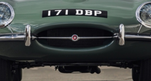

Apart from the head topic, imho the bonnet mouth is of the later bonnet version and not the slightly smaller early welded louvres (incl OBL) bonnet mouth. So I assume, they simply took a later bonnet and converted it to the early one.
Btw: same with 885018.
This implies the next question; which louvres and flanges did they use?! All louvres repros offered are to my knowledge not correct and have the wrong profile. I have one of the lastest repro sets lying next to some original louvres.
Issue with mouth (and with louvres / flanges as well) is: if it needs correction, you always have to repaint at least the bonnet, if not the whole car. And if you go for a complete repaint, it is almost the whole hog again.
Here is a pic of a believed to be original early bonnet / mouth:
versus:

Post by splosh » Sat Jul 18, 2020 7:34 pm
from "Xkedata.com"
" In the early seventies the bonnet was replaced with the standard inside lock and pressed louvered type, "

Post by wagstefan » Sun Jul 19, 2020 1:28 am
from "Xkedata.com"
Yes, I know.
But when restoring and converting it back to a welded louvres, outside nonnet latch bonnet, this could have been considered...
In particular when you ask top money and stating this car to be in a superb condition, which has won several concourse competitions
But yes, this type of mistake can broadly be seen. I think even the McLaren E-Type had this wide mouth when being advertised for sale.
And my point here is: rectifying spinners: easy. Cost you maybe 300-400 GBP. But this is a bigger thing with the need to redo the paint job, at least on the bonnet

Post by Desmo » Sun Jul 19, 2020 9:07 am
Hello,
Stefan is right. Here a further picture:
[img]https://i.postimg.cc/jjd6Vhgy/PICT1046.jpg[/img]
