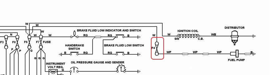

Posts: 13459
#19 Re: s1 3.8 Solid State Fuel Pump
Post by Heuer » Tue Aug 11, 2020 12:18 pm
johno560 wrote:
Tue Aug 11, 2020 11:00 am
"Further update from the technical team:
The pump does not have any fuse protection in a standard harness, so any fuse failure issues he has cannot be related to the pump unless his wiring has been altered and is now non-standard"
They have confused the 3.8 with the 4.2 as the latter has a fuel pump with no fuse in the circuit. The 3.8 certainly has a fuse as you can see below:
So either SNGB need to make it clear the new pump draws 5A and the fuse should be changed to match or (better still) provide a suitably rated fuse with the pump. There is no technical reason the increased draw of the new pump should cause a problem as it remains well within the spec of the loom.
There does appear to be considerable angst among some owners who want to reduce the electrical 'consumption' of their cars mostly seen in fitting LED lights.
Lights (full beam and sides) = 14 amps
Heater motor = 7 amps
Wipers = 5 amps
Ignition = 2 amps
Fuel pump = 1.8 amps
Alternator energiser = 3 amps
Cooling Fan = 6 amps
Total = 38.8 amps assuming we are using all of the above at the same time. Add 3.2 amps for the new fuel pump. The alternator is 60 amp (hot) and the battery 43Ah so nothing to worry about.
S1 OTS OSB; S1 FHC ODB

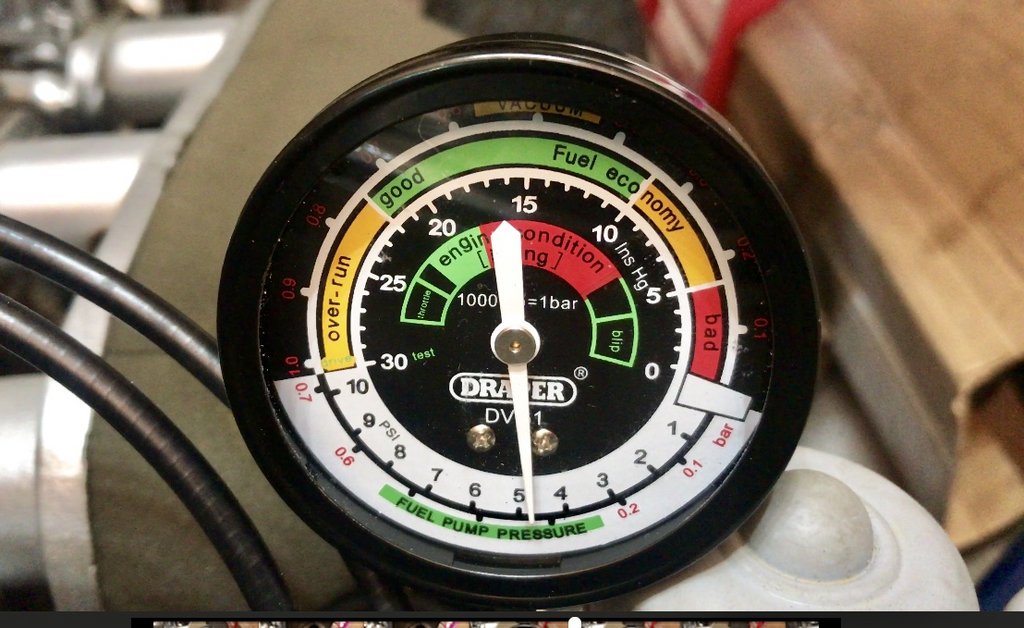

Posts: 1201
#20 Re: s1 3.8 Solid State Fuel Pump
Post by rswaffie » Tue Aug 11, 2020 1:39 pm
I’d be more concerned that the solid state 3.8 operates at over 5psi which can cause flooding.
