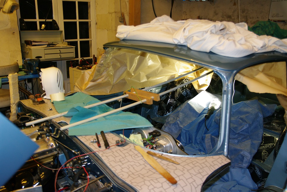

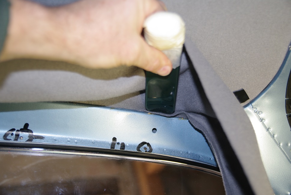

May be it can Help... (take care about the temperature with Neoprene glu)
I have slided the headliner on the two pvc tubes so i could press on the middle following the line front /rear marked on the roof and on the Head liner
It's easier all around to stick after the center already glued
