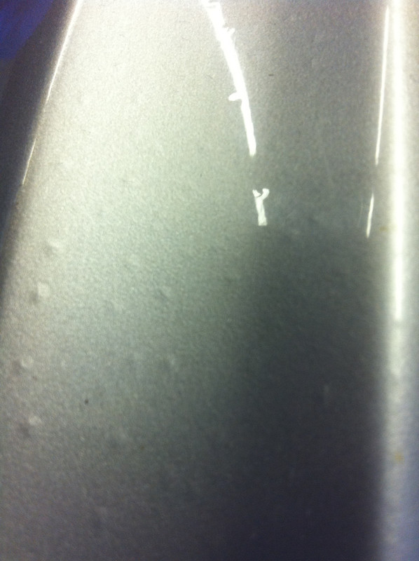

This I find an interesting topic because I have a Healey 3000 which I've had for some three years now and the micro blistering is getting worse. It had none when I bought it. It came with a soft cover which I've used when the car stays in the garage. All I've seen on micro blistering discussions seems to suggest it's caused by bad prep when the paint was applied, no one has ever before mentioned keeping the car covered. Now I've got the E as well, I bought an indoor "breathable" cover but now I'm scared to use it.
How many people have suffered micro blistering that they think was due to keeping it covered. My garage is insulated but not heated nor de humidified.

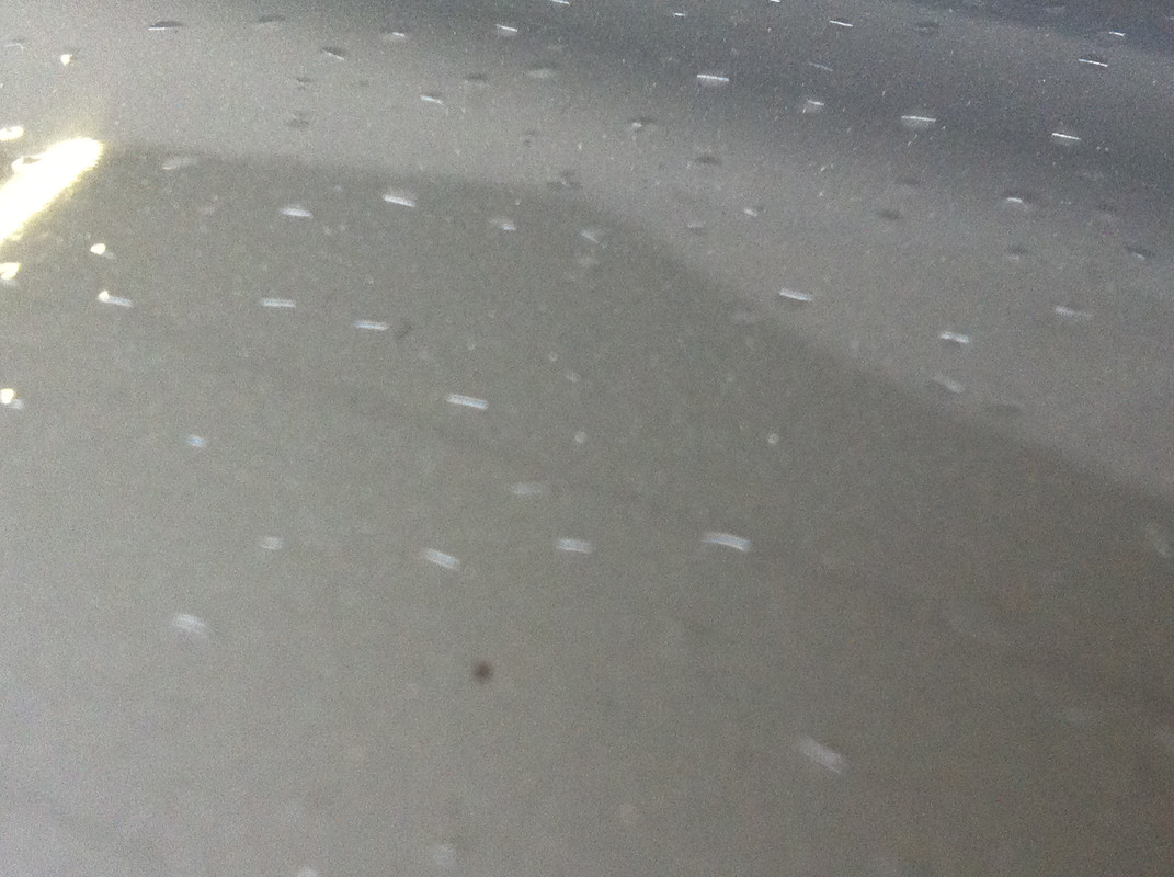

Unfortunately I am suffering from it on a car which I bought recently ( Opalescent Golden Sand Mark 2) where it had been covered for years and years, and where the paintwork still looks to be in good order until you look at the roof very closely , when an absolutely uniform covering of very small pimples can be seen over the whole surface . One of the factors which makes our climate so pernicious, and which may not apply even in Ca, is that we often have a spell of perhaps 4 or 5 days of temperatures of perhaps 25 degs F, followed by a sudden rise to 45F which results in the cars being absolutely covered in sweat for a day or so . The more usual microblistering from poor refinishing is much more patchy , and much more obvious and deeper in extent , on my S2 E
