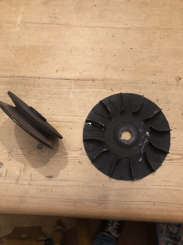

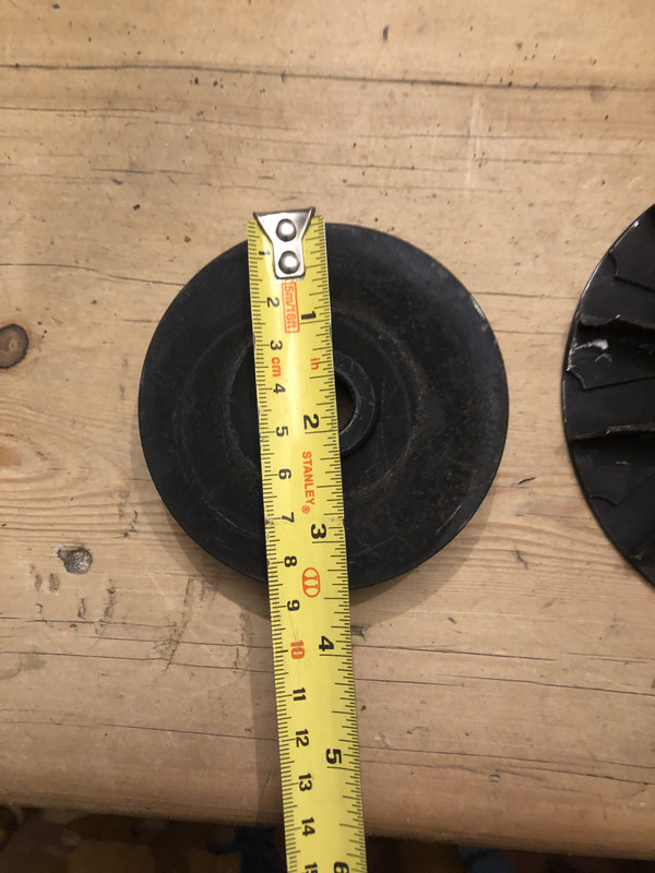

Can anyone tell me if my dynamo pulley is the correct diameter please?
3.8 1962 R4095
C42 Dynamo
My Pulley is 3.5 inches diameter
See photos
Robbie

Should be C18227

Nawang61
Posts: 6
Joined: Mon Feb 08, 2016 12:19 pm
Location: U.K.
#9 Re: Dynamo
Post by Nawang61 » Wed Jun 12, 2019 6:35 pm
Hi, my 62 car has 3 1/8 dia. See pictures and has double groove pulley.
Llllllllll

#10 Re: Dynamo
Post by Robbiee » Wed Jun 12, 2019 6:45 pm
Mine has the slightly earlier March '62 single groove
It looks like my pulley is in the right ball park for diameter
Robbie

#11 Re: Dynamo
Post by ALAN COCHRANE » Wed Jun 12, 2019 9:03 pm
Robbie
I've just measured mine and it's 3&1/8" in diameter and single groove.
When I bought my car in 2011 it was running with a Lucas 11AC alternator and this size of pulley wheel brazed onto the front. I discovered that this was because the shaft of the original dynamo is slightly wider than the equivalent on the alternator and this setup was cobbled together to keep running with the single V fan belt.
I subsequently found another pulley wheel of the same diameter that fitted directly onto the alternator.
Apologies for the long winded answer.
Alan
