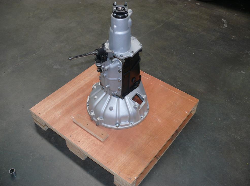

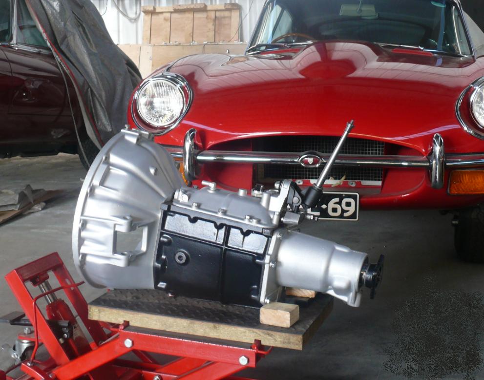

I provide a Gearbox Repair/Rebuild service as part of my E Type Restoration business and use Redline MT 90 in all gearboxes I rebuild. Following are a couple of pictures of a completed S3 Gearbox nearing being ready ship.

I never ship with the stick attached. Have seen two top covers snapped off by rough handling. Agree on Redline and also found Castrol synthetic gave a noticeably smooth change.
Hello Peter,
The pictures were taken for the benefit of the client, so he could see his finished Gearbox. The Gear Stick is removed when finally packed.
