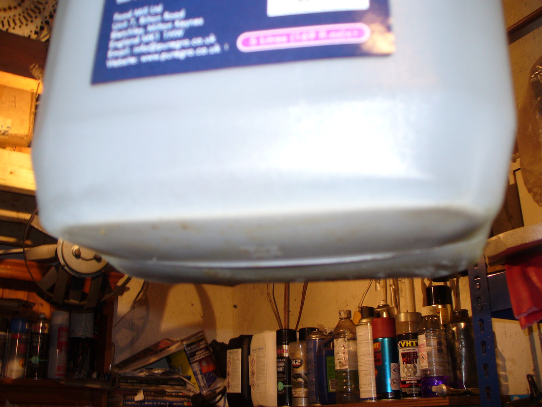

When I cleaned the radiator of my E-Type, the process was quite effective. A lot of material was removed, principally in the form of a white-ish emulsion (so a lot of material in suspension) that required a number of further rinse operations to finally get clean liquid afterwards.
Pictures of the process.
20 liters of milky liquid removed from the cooling circuit after treatment with diluted phosphoric acid:
And what remains after disposing of most of the liquid:

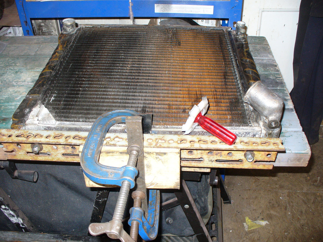

Soaked in 5l of white vinegar, drained out and refilled a couple of times leaving the sediment.
About 7 days total. It did disolve out more than I thought and some sediment collected
Flushed out with boiling water afterwards
Mixed a 400ml bottle of Kilrock with 2 jugs of boiling water and topped up the rad and left for a few hours.
Emptied. Refilled and then flushed through with more boiling water. Very little sediment coming out.
Would be better if I could pressurise it to force out any more stuff lodged inside but overall pretty happy.
I am going to fit the original type single blade fan so wanted it as clear as possible.
Bottom of the rad is bent up (usual car jack error) but should pull out and no obvious damage to the pipes.

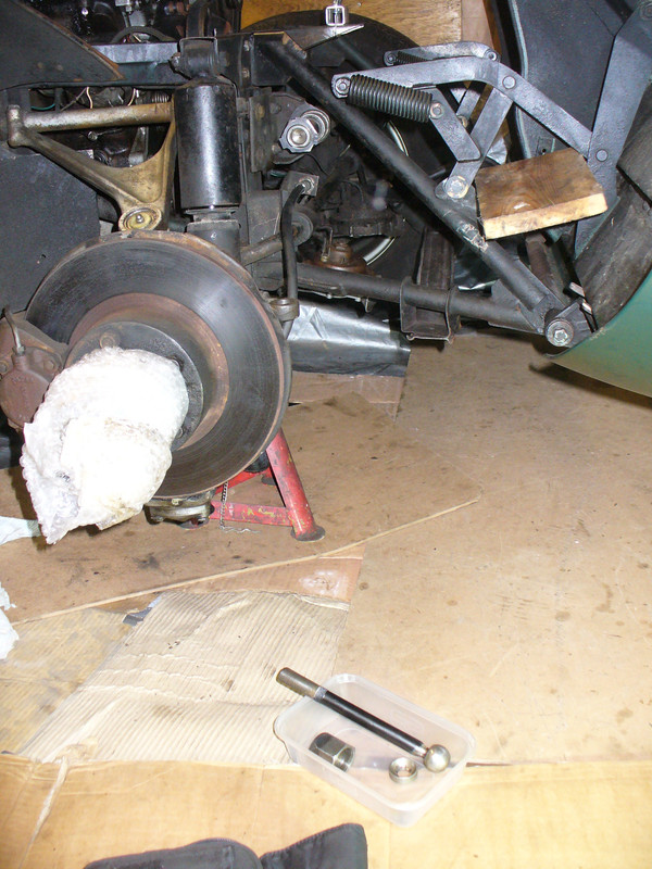

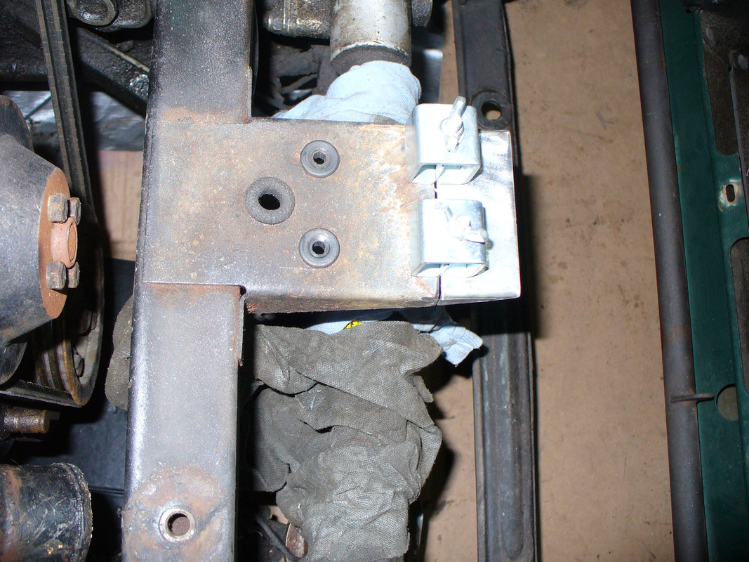

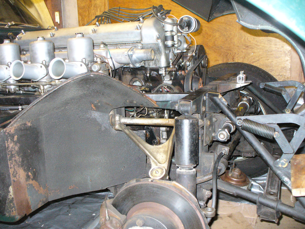

Couple of shots- Fan mount end was chopped of, new section ready for welding. Steering rack was missing spring and lock washer.
Eddie

On the home straight
Taking the bend out of the lower Radiator frame.
Little Fin straghtener from E-Bay worked really well
