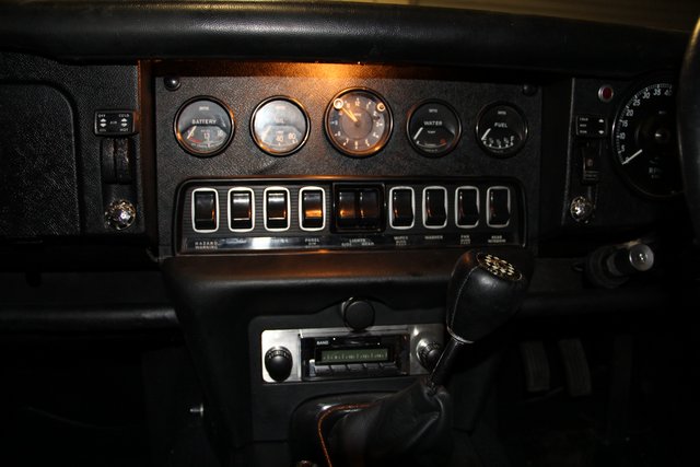

I recently fitted one of these radios
Its actually quite difficult putting any sort of decent speakers in an e type
And there is a lot of wiring on the back of this radio as well as it has a lot of functions
I researched what others had done and really there is limited scope to fit a decent set
Treble isn't the problem really but the A post fitment is straight forward
Its base really thats the problem
I fitted 2 speakers to the centre console next to the radio and then an active flat panel sub woofer under the passenger side foot well
Without the sub woofer you just can't get any sort of base due to the size and depth of the speakers you can squeeze in
I couldn't see anywhere I could fit decent sized rear speakers
I considered a FLY active sub woofer to go in the luggage area but it would have looked out of place
One other thing is that I would recommend fitting a dedicated suppressor for the radio and a better active DAB ariel
The one that comes with the radio is a bit poor being one of those small sick on the window things
Joe

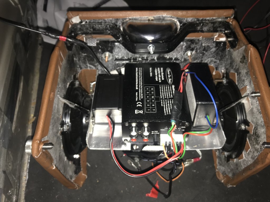

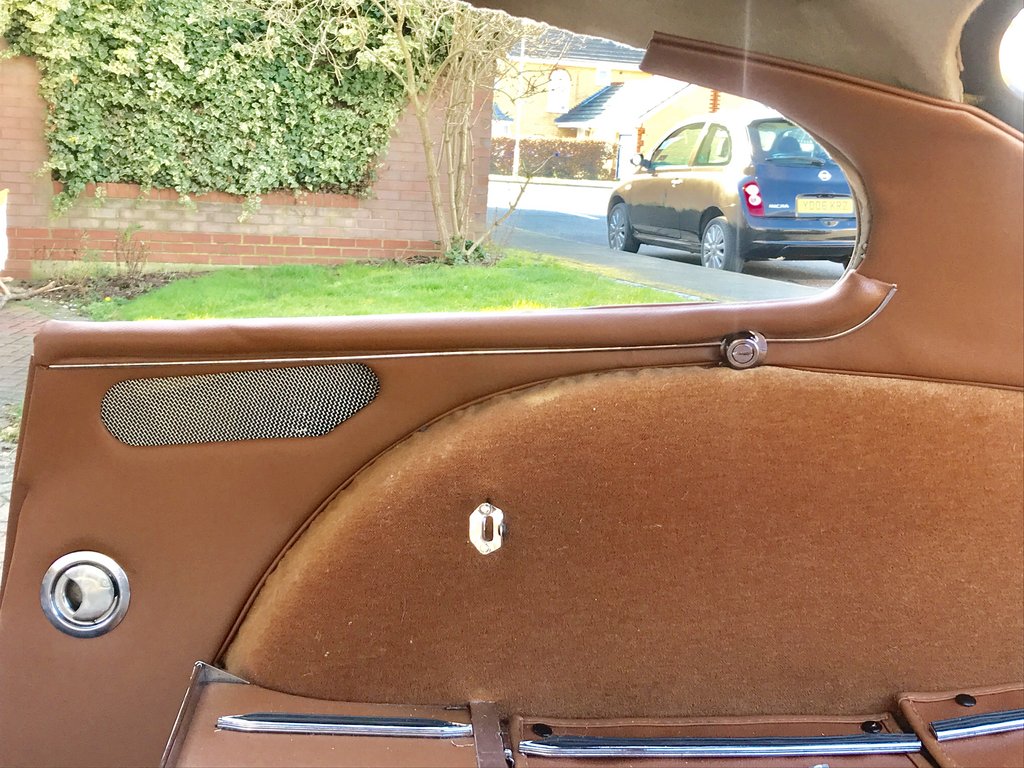

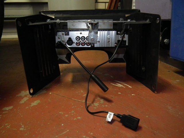

I went down the hidden Bluetooth receiver/amp route. 4 channels and small enough to allow decent pioneer speakers to be fitted in the centre console holes. I did need an extra module with the amp to allow it to work with positive Earth. Then I fitted Pioneer TS-G1310F Speakers (without their stock grilles) into the B post pockets, making my own grille to cover them.

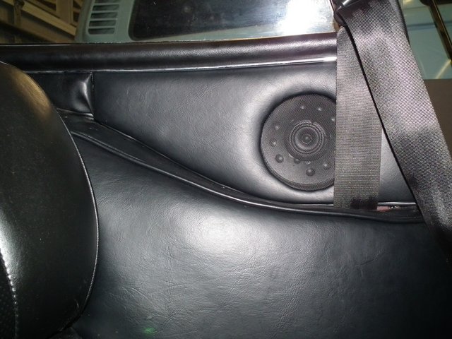

Not sure if a Series 3 is different, but here are the speakers on my Series 3 2+2:

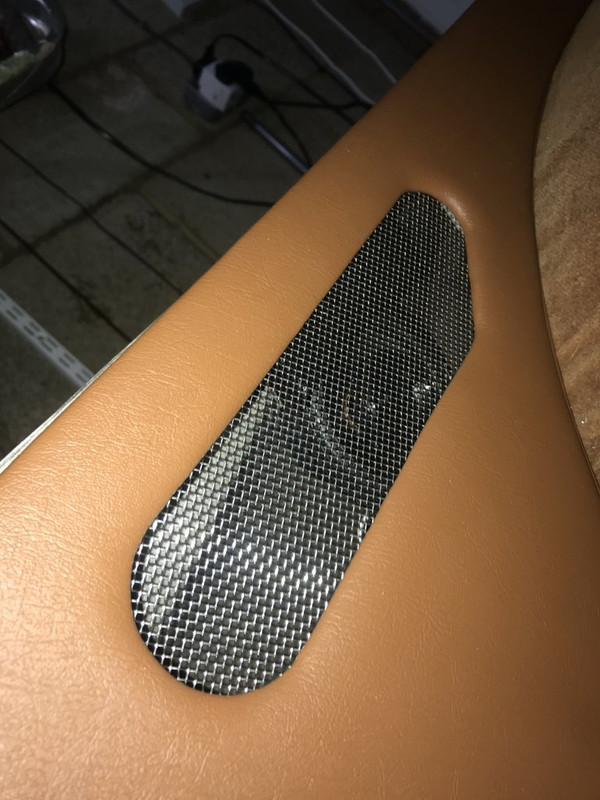

I used the original grill from the Kenwood speaker as supplied, flattened it and secured it behind the panel. I seem to remember the speaker was grey and very visible, so I lightly spray painted it black. Also, to get the biggest speakers in that I could, I had to slightly trim the speaker chassis, using snips so that I did not create iron filings which would have inevitably ended up on the speaker magnet.
Incidentally, the Series 3 includes the speaker wires in the loom and that's where they come out.

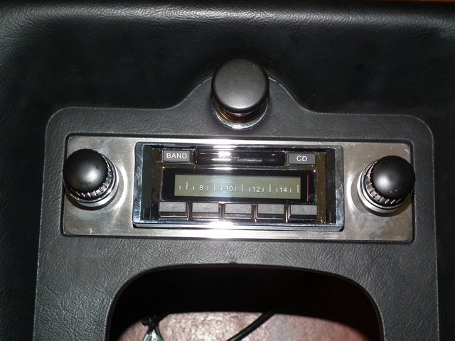

The Radio is a modern from Custom Autosound, which you can customise by moving the knobs in or out relative to the tuning dial - if you take measurements, you can have it assembled to suit straight from the box. It came without a fascia, so I simply cut a piece of stainless steel, then sanded it carefully in a horizontal direction to get a "brushed effect". Takes USB and the current range are also Bluetooth - mine has a blukit, allowing me to connect my iPhone via a 30 pin connection and adaptor, a little clunky, but workable.

#9 Re: Car radio
2+2 shells are all the same i think
I dident look behind those side panels
So I may fit a pair of speakers there
But looking at yours they seem very similar to the ones I fitted to either side of my radio consul
Very shallow dish which don't give any meaningful base
I couldn't find any speakers that gave good base in any of the dimensions that would fit
Joe

The space is hollow, so you have the whole rear wing behind there. I doubt there is a larger hollow space in the car, probably bigger than the space behind the door trim.
For more bass you will need a sub woofer under a seat or one of the modern custom units which would look pretty out of place.
