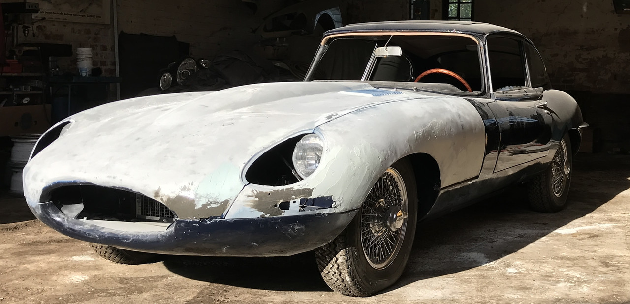

Post by Durango2k » Mon Jan 01, 2018 6:07 pm
The weather gods were kind today : +13 degs !
So, here we go: put the bonnet on the car looseley (just laid it down). And methinks it fits !
I crawled under it, and checked the hinges. No problem in using a few shims, but to me it looks like I won‘t be needing to many.
How would you arrange fitting the shims - buy a quantity from SNG and return the remains ? I don‘t know of any „loan service“ to fill up after the loan ?
Next, maybe tomorrow: drill the 7 mm holes for the lamp surrounds, and get some gas, to weld the cages inside the wings. I have put the glasses loosely on the bonnet: fine !
Carsten

..this is how it currently looks from different viewing angles:
