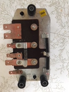

On the back of a Lucas RB340 v.r. there are three tubular items connecting metal tabs...what are these items?

Post by Heuer » Tue Sep 18, 2018 6:28 pm
Wire wound resistors.

Please look at the back of my failed unit...it appears one of the wire wound resistors has burned out. Can this be easily and cheaply repaired?

Post by cactusman » Thu Sep 20, 2018 7:06 pm
Wire sound resistors.are.available from, among others, radiospares. Www.rswww.com.
