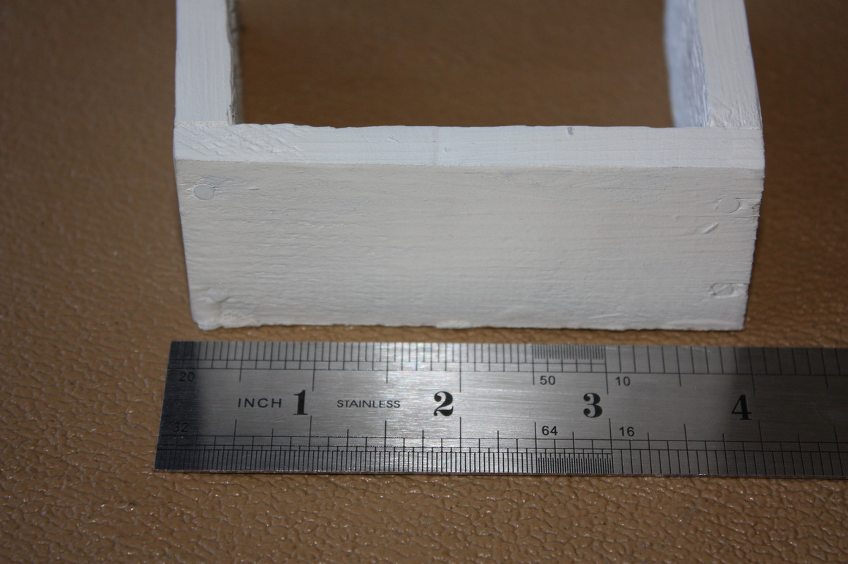

As a post script to my earlier post, I made this thingy to help keep items in the boot away from the catch. Obviously, one should be careful before closing the lid to make sure that nothing is near the catch, but this device adds another layer of protection and doesn't interfere with the closing of the lid. The notch is sized so that the barrier slides snugly between the boot floor and the lip of the tub.
