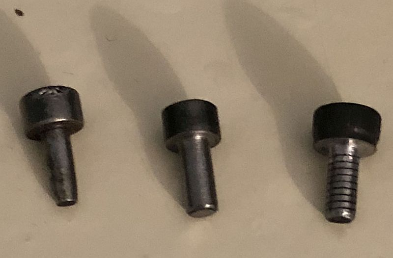

Just for the exercise I turned one up out of a grade 8 bolt in about 5 mins on my lathe. As all it does is stops the piston from returning too far I'm sure that if you made one it would be perfectly safe to use it.

Trying to make it even easier. I turned one up out a 5/16" bolt so you don't have to machine the top. The top diameter is 5.88mm so a little smaller but will work.
Another option that occurred to me was to turn down the threads on an M4 capscrew. I did this in my lathe but you could do it by chucking the capscrew in a drill and using a file to narrow it down.
L to R original, 5/16 bolt and capscrew.

The idea with the M4 cap screw worked perfectly , filed one down to the dimensions on your drawing, fitted first time.
