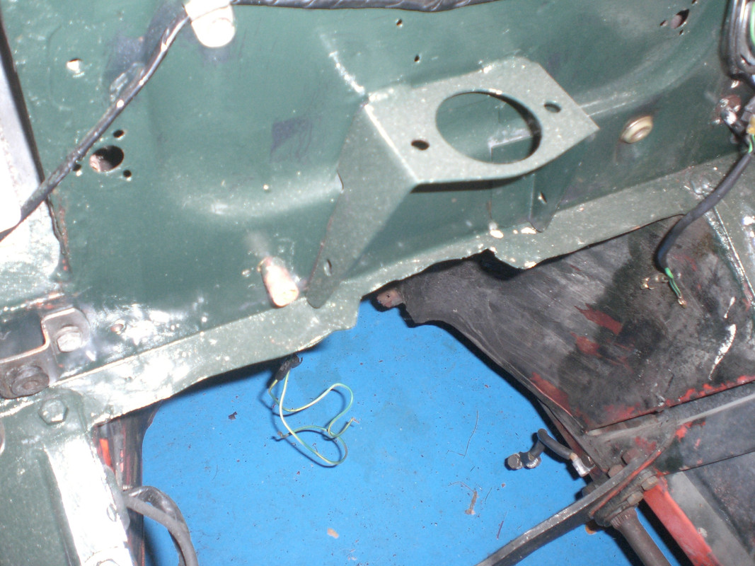

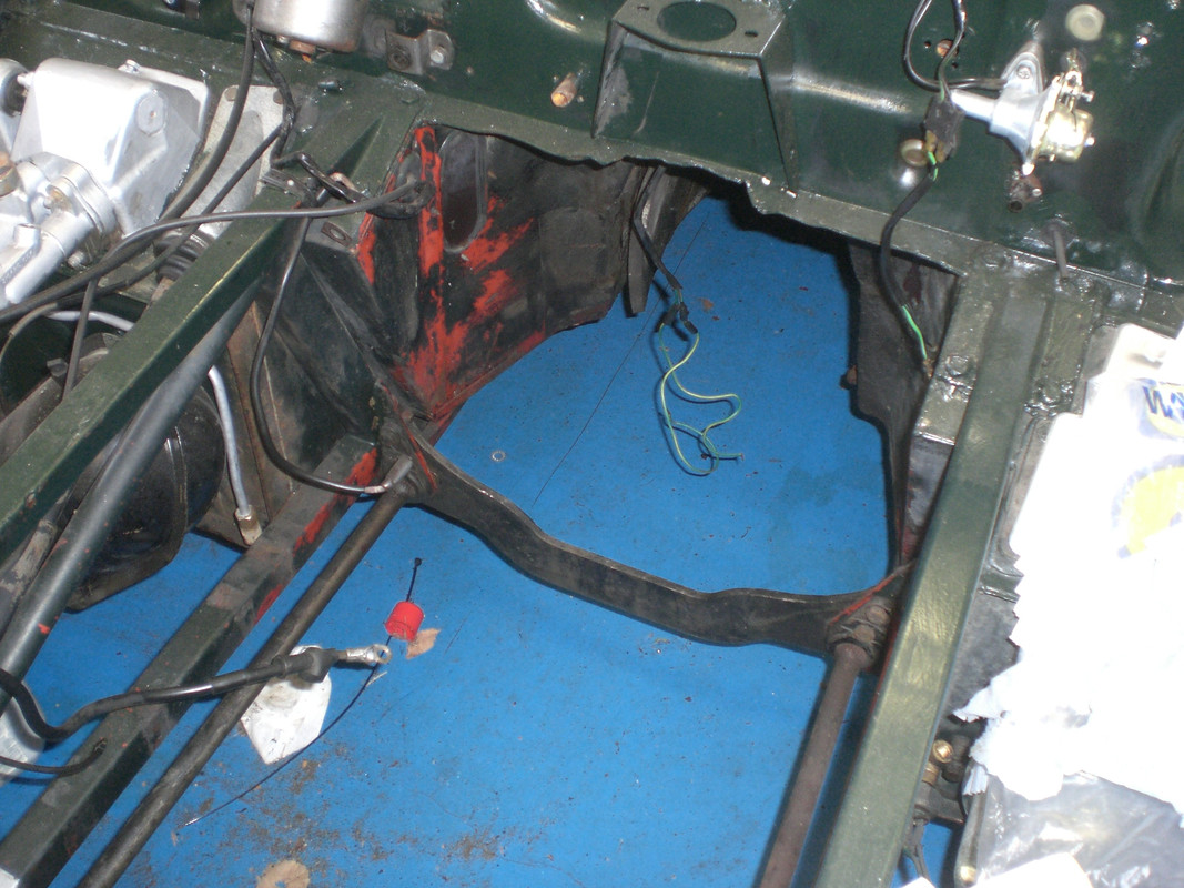

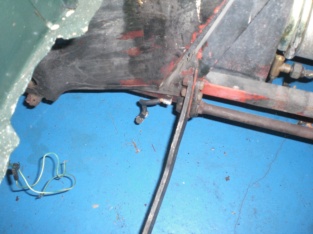

Post by E600 » Thu Nov 29, 2018 1:50 pm
Below are pictures of a swb E Type with the engine and box removed and the Reaction Plate still in place. The engine and box were taken out a couple of weeks ago so I missed the opportunity to photo the extraction. Hopefully I will be able to catch the replacement.
Note the top flange "damage". I have seen similar (and worse) post removal with the plate removed.
For this method the bottom pulley and both the exhaust and inlet manifolds are removed. Centre console is removed along with the gearstick and the engine stabiliser complete with the two brackets.
Again I stress this is not my preferred method, just how someone chooses to do it, I am just confirming it can be done without removing the reaction plate

#47 Re: E type reaction plate
Post by Doug Buchan » Thu Nov 29, 2018 2:47 pm
Pat,
How high does the rear of the car have to be to make this work?
I've been R&Ring these since 1976 however I've only done the job the (formerly) two other ways.
I'm impressed.
Doug

Posts: 3958
#49 Re: E type reaction plate
Post by PeterCrespin » Fri Nov 30, 2018 3:28 am
Wow, 30" raised at the back, and the front up some as well?
The exta stuff that has to be done and removed sounds like it takes longer than loosening but not removing two torsion bar bolts per side, plus one frame rail bolt per side. And all of it can be done single-handedly, quickly and with no body damage, instead of getting some men round to help.
If there was a stopwatch involved for two solo efforts, I know which one would be quicker and more stable/safe... Thanks for the pix Pat
