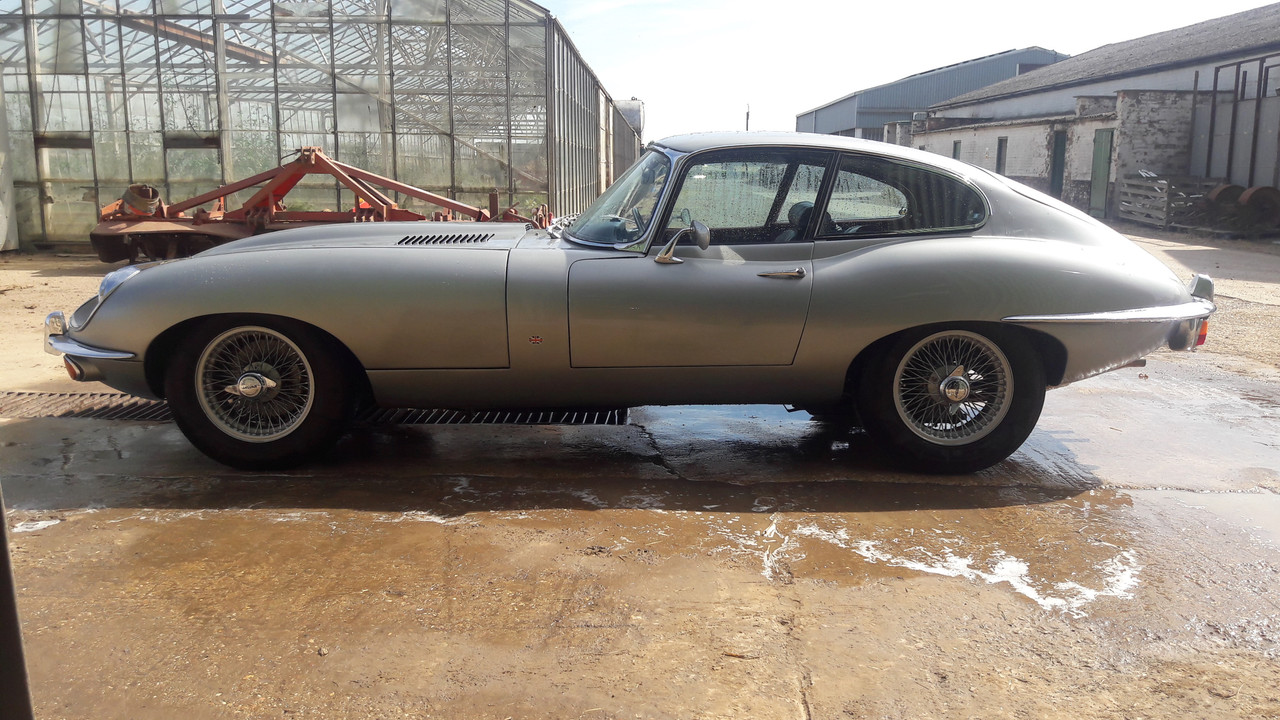

Just out of interest, what number was you car? Looks just like mine that was made in December 1969 and was registered on the West Coast in early 1970.
Mine is 27187
It now lives back in the UK

Looks nice @politeperson,
Mine is 1R27089, not far off.
However, the original color of mine, was light blue. My grandfather had it repainted in the late 70s, preferring the silver, which is a correct XKE color, like yours.
