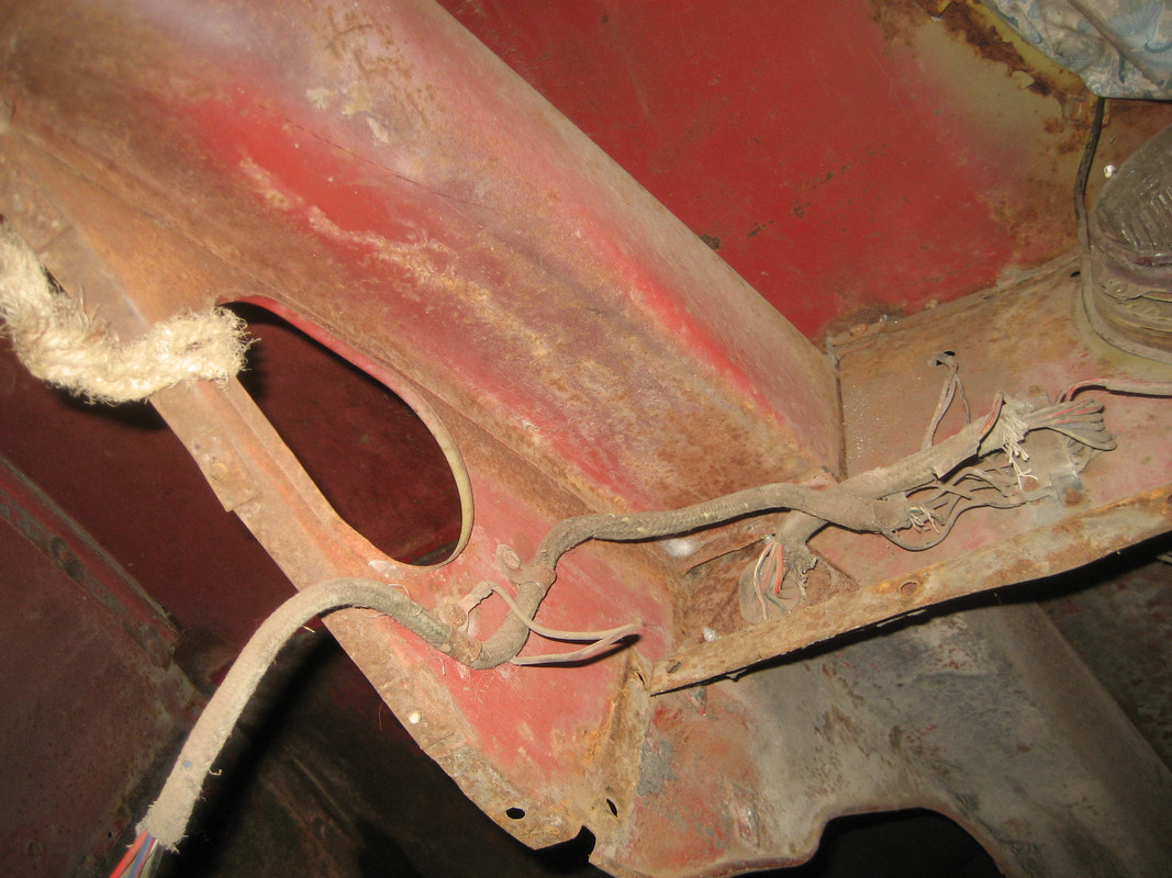

Hi Carsten,
This is a picture of the left hand side as I was stripping the bonnet:

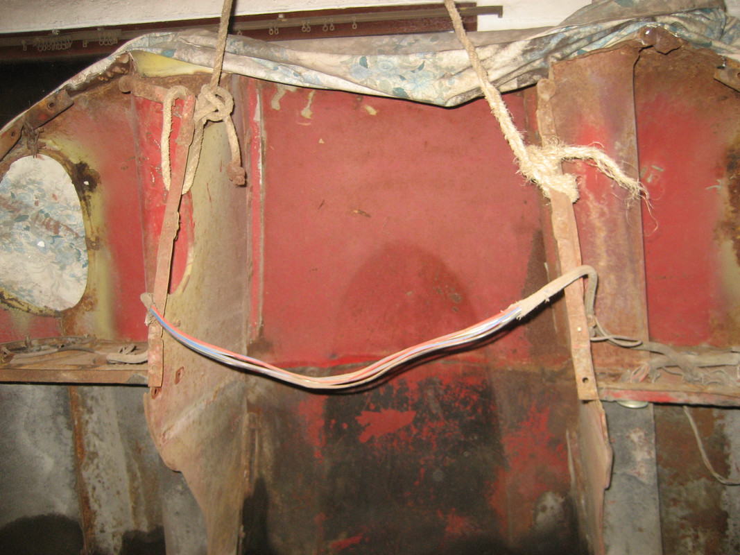

The right side:

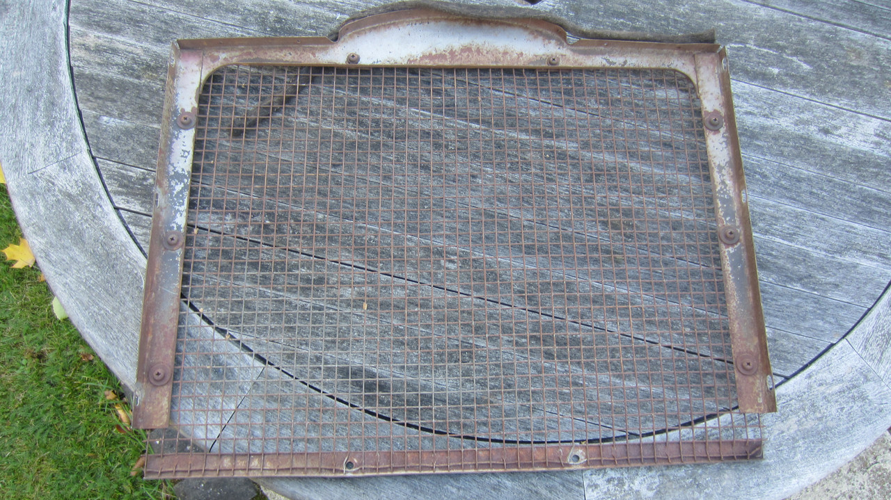

Stoneguard:

Durango2k
Posts: 1236
Location: Germany
#4 Re: Series 1 bonnet wiring loom fixation points ?
Post by Durango2k » Sat Dec 22, 2018 10:20 pm
Many thanks ! That is what I needed !

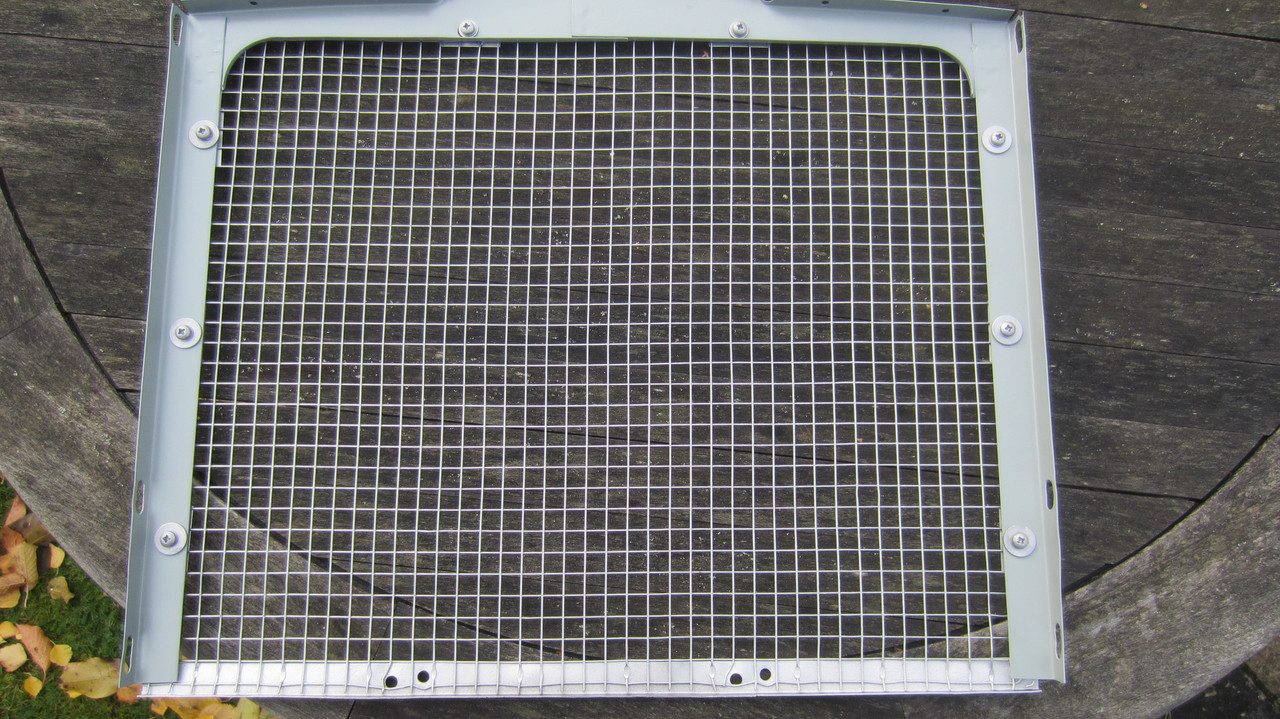

Unfortunately I do not have a picture of the stone guard in its new position at the moment, but this is my converted stone guard.

The bonnet picture you posted shows three sideway holes mostly even spaced like x..x..x. Thats a Series 1 part. Spacers needed because it is further back / nearer towards the radiator.
The one you adapted is like mine, like x....x.x. Thats an S2 part. No spacers needed because its nearer towards the nose.
I‘ll stay with the S2 one - it will work and it looks nice, „as it should“.
So, we‘re all left with just one question, then (music of X files in the background....):
Why did they include both sets of holes - does it not mean that from a certain point onwards, they knew what would come, and included both sets of holes ? But why ? To ease the spare parts debate - one item fits both models ?
