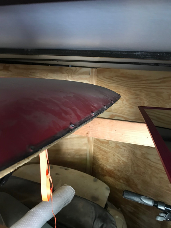

I have a Hardtop for my 1961 S1 OTS .
Whilst I have all the Chrome trim for it I do not have any of the fixing clips / screws and non of the parts stockists seem to list them in there parts ?
Across the leading edge, of the hardtop, there are 13 ( roughly 3mm ) holes , but I need to know what are the appropriate trim clips ( are these screwed in place or pop rivetted ? )
Also what are the correct screws ( size , thread , c/sunk? , domed ? slot or pozi ) which hold the Cant rail chrome and corner 'flash' chrome in place
Thanks Martin

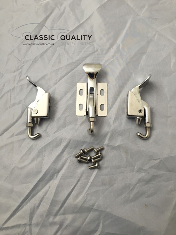

Post by Heuer » Tue Mar 12, 2019 12:15 pm
Classic Quality Parts specialise in hardtop chrome, fixings and fibreglass: https://www.ebay.co.uk/str/JaguarMan198 ... 7675.l2563
Are these the parts you are looking for?
£175/set: https://www.ebay.co.uk/itm/JAGUAR-E-Typ ... 0005.m1851

Hi David , thanks for the reply , but those are not the parts I need .
Its the little trim clips that hold the chrome strip across the leading edge of the hardtop
and the screws which hold the other bits of chrome trim on

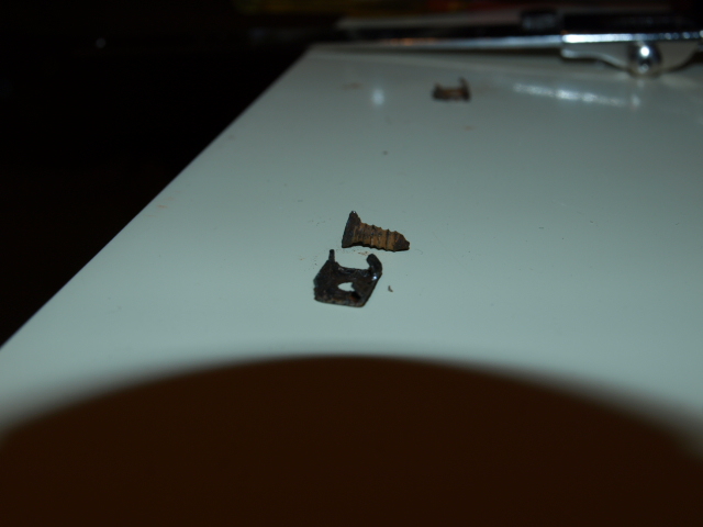

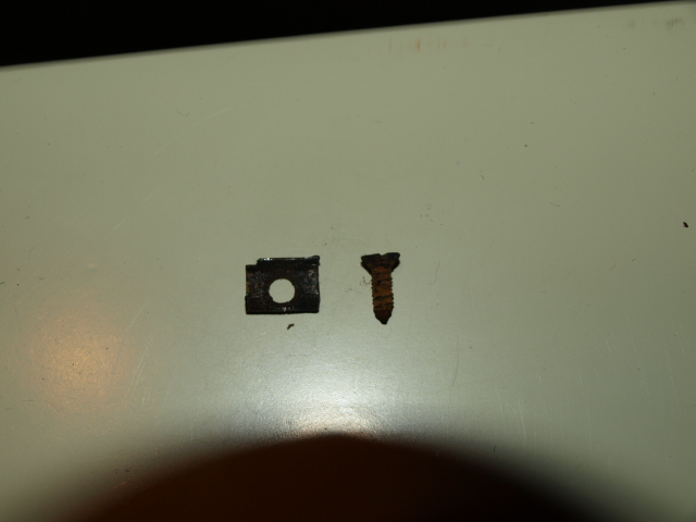

Hi Martin
As update to our last note. Measuring the clips and rivets was not easy as they are heavily corroded but eventually I managed to remove the clips and screws to get them under a magnifying glass to check shapes and sized, the rivets proved more difficult to measure as they were all slightly distorted from having the trim taken on and off over the years, but eventually again a nominal value was arrived at. You will see in the pictures that there is also a rubber pad to each corner of the hardtop below the side chrome finishers, this is a fairly hard rubber/foam? and again I am trying to get a couple of firms to identify it.
1. The clip measured 10 x 7mm with a 3mm diameter mounting hole in the centre
2. Retainer screw is a countersunk No.4 x 5/16" (they appear to be woodscrews rather than self tappers)
3. The Rivet is 7.2mm approx. (9/32 - 5/16") length not determined until one is removed.
4. The screws to the underside edge of the chrome finisher on the side are domed chrome No.6 x 1/2" (5/32 x 1/2")

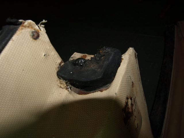

5. Corner rubbers 50 x 50 x15mm
I have done a little more research on the hardtop chrome strip fittings and can point you to a very comprehensive catalogue of all sorts of trim clips and fittings, not just Jaguar but for many British cars. There are perhaps too many pages to print but download the catalogue to the following,
The site is www.bresco.com,
pages 29, 30,38 and 39
item number 17750P for the moulding clip
item number BSF079P for the Tucker rivet long version
item number BSF223P for a shorter version

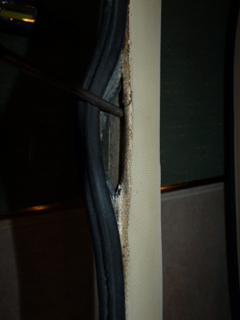

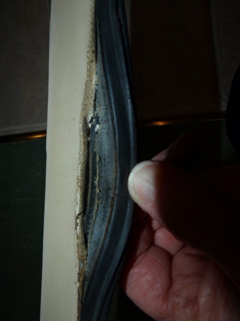

I have finally managed to draw a section of the sealing rubber around the base to the rear of the hardtop and will send it to a couple of people for them to either research and find an existing section or to quote to have some made. The section on my hardtop is different to most that are being advertised on the net and I know is the original. The best way I can describe the section is like an upside down tooth with a long root from the centre that fits up inside the two skins of the hardtop.
If the pictures turn out you will see that I have a screwdriver pushed into the aperture to show where the headlining material is glued and folder into and ultimately where the tongue of the seal is also glued into. Once in place the seal has a small lip of approximately 12mm covering the inner edge inside the hardtop, on the outer edge you may see in the photographs a brown glue line to the edge, that is where the seal virtually abuts the outer edge rather than having a lip up the outside (I hope that is clear). So when viewed in place the hardtop now has a nice flush appearance with the seal hardly showing, rather than looking like that of a windscreen rubber as most of the options currently available. It may be of course that Jaguar subsequently went over to the windscreen type seal for ease of production line assembly, but I have not found anyone to verify this.
Will keep you informed, I have attached some pictures and hope they come through.
Tony

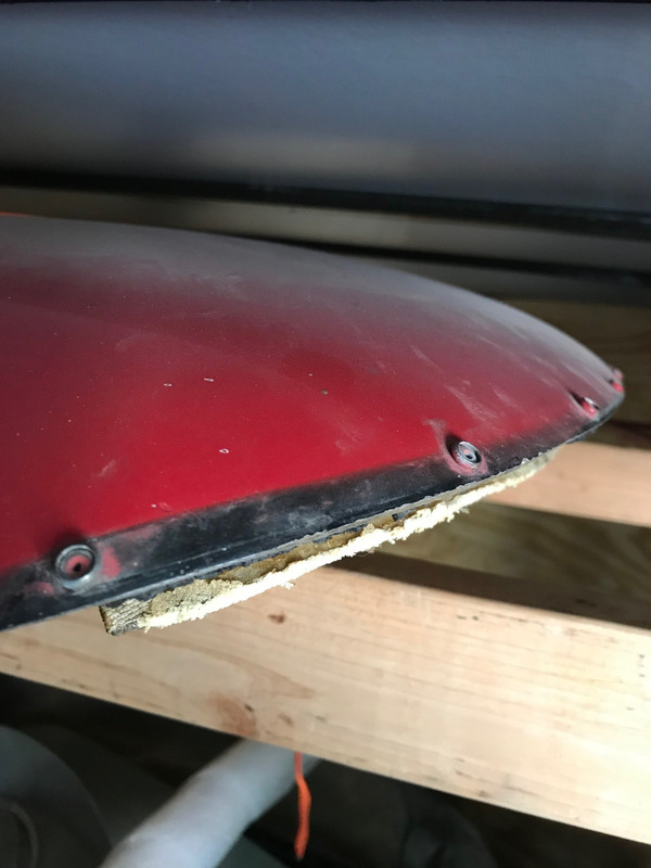

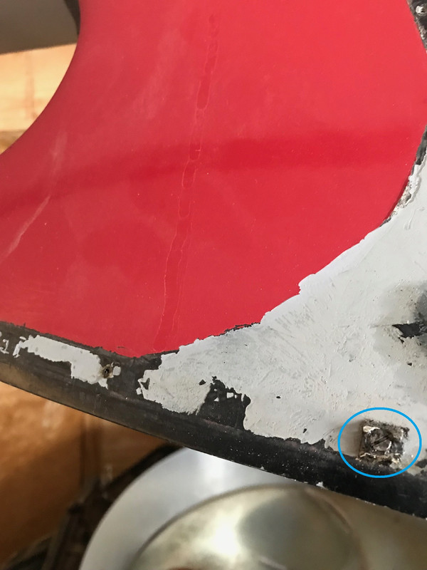

Post by Geoff Green » Sun Apr 21, 2019 8:13 pm

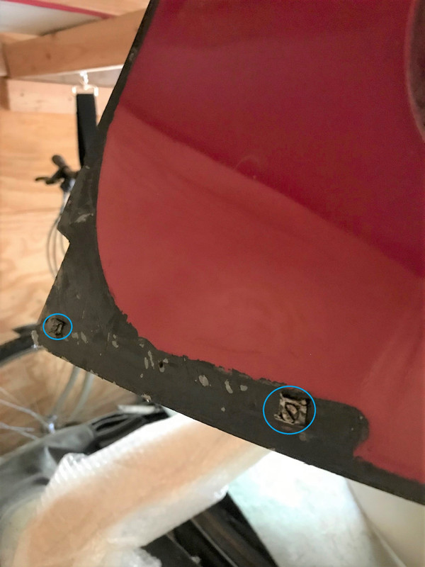

My factory hardtop has the rectangular clips holding the corner trim at the side window, body, door handle area. Somewhat triangle shaped.
The chrome across the top front above the windshield is held on with round clips similar to the round clips holding the headlight trim on a series 2 / 3.

Post by tonyabacus » Mon Apr 22, 2019 9:04 am
Not sure if we are talking the same parts, but here is another photograph of the clip in the area you describe as fitted to my hardtop. Looking at the chrome fitting I don't think there can be too many alternatives to the one in my pictures.
Tony

Hi Tony ,
Thanks again for another very complete answer to my original query.
I have checked out the Bresco site, seems quite a selection .
Your ( wood) screws that hold the clips across the front edge seem a trifle long ? don't they foul the rubber sealing strip , or was the rubber seal strip fitted before the trim clips so that the screws actually screw in to the rubber
The rear seal photos were fine and I have to say what you have does look a much more elegant solution than the current offerings, which look cumbersome . I would certainly love to hear if you find a supplier .
Thanks Martin

When you say across the front edge I take it you mean the horizontal edge that abuts the bottom of the cant rails?
The clips I refer to are those rectangular ones that hold the trim to the sides of the hardtop shaped like a letter 'L'. Having rechecked the size they are definitely 5/16ths. The two holes they fit into are 1/2" up from the horizontal edge of the fibreglass and as you suggest it seems perhaps the rubber was inserted before the chrome trim, the rubber is approximately 13/16ths total depth and the 'tongue' approximately 5/8ths depth.
I have not as yet completely removed the rubber seal so cannot confirm the above, but I think we share the same idea.
Once I get a response from the firms I have sent a drawing to about the seal I will post some detail.
Have you loosened the seal on your hardtop to see if it to shares a dual skin where the 'tongue' on the seal fitted on my car fits into, this at least would confirm that the hardtops are the same. I can't see Jaguar changing this method unless or until the moulds wore out, but even then it would have been easier just to replicate what they had.
One problem often reported is that the hardtop obviously moves slightly when going over different road surfaces, this leads to some rubbing of the paint. But it appears to me that the seal supplied these days from the different sources I have seen, appears to be quite a hard rubber which may account for the rubbing, whereas the rubber I have seems softer and so might sucker down onto the paint better meaning perhaps the top is held in place better and hence less rubbing as the top moves. Hope to get further advice on the grade of rubber when the firms get back to me.
Tony
