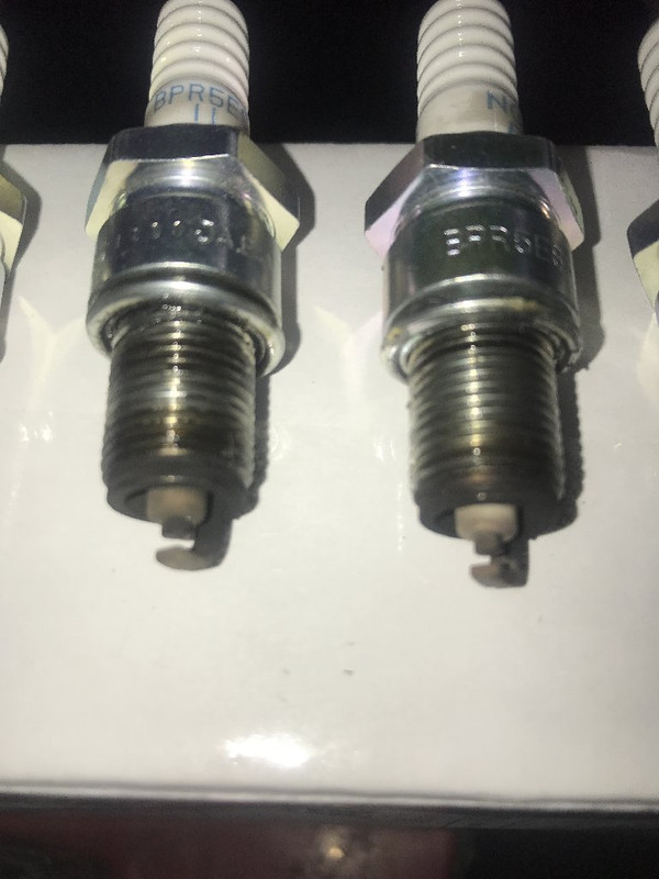

I decided to check the condition of my bpr5es plugs after 400 miles of running in my rebuilt 3.8 engine.

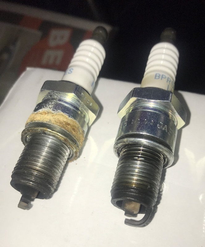

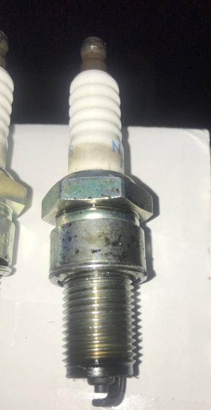

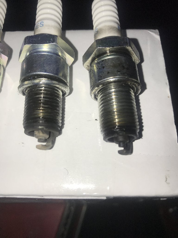

My question relates to plugs 1 and 6, as the others seem ok. Plug 1 was a bit wet with an oily substance and the electrode is quite sooty. Plug 6 also seems sooty but not wet but it does have some sort of crusting around the top. Any thought as the what may cause the condition of 1 and 6, and do the others look ok?
Plugs 1 & 2, (1 on the right)
Plugs 3 & 4, (3 on the right)
Plugs 5 and 6, (5 on the right)
And a closer view of number 1

They look pretty OK to me with the exception of no 1 which looks mildly sooty.....I'd not be concerned...

The crust on number 6 could be from water standing in the plug well. Possibly getting in through the louvres? This will obviously evaporate off when the engine runs.

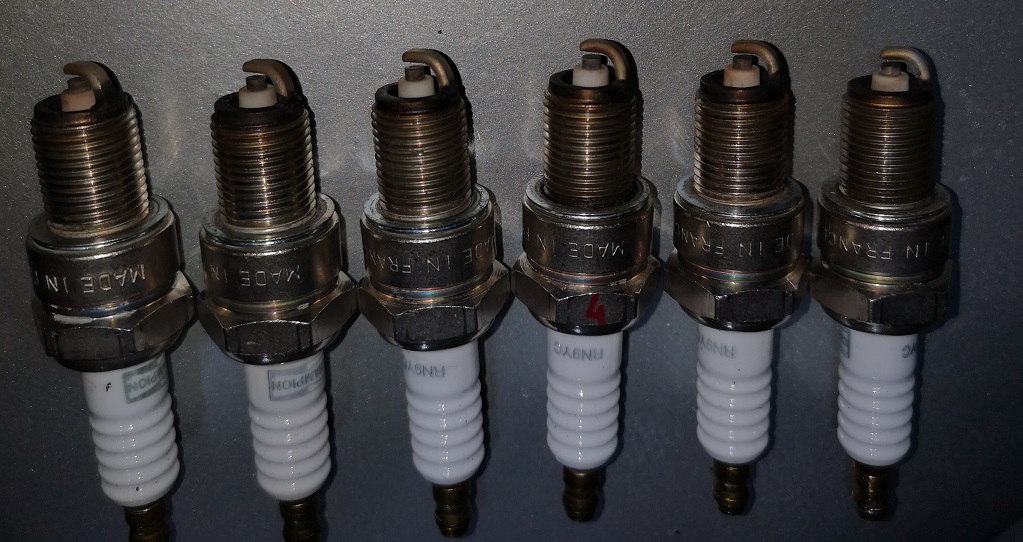

For comparison, here is a pic of my plugs after 1500km:
