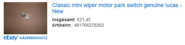

#11 Re: Wipers won't stop
Glad you have correct functioning wipers. Please let us know which of the six were correct by part number. Thanks in advance.

#13 Re: Wipers won't stop
@ Polse: Thank you! Will try to follow your advice.
Here are the details for the switch:
Bought 2 switches each via EBAY (so indicated price is for 2 switches). Both sellers are in the UK and shipped very fast. If I would have the problem again, take my advice: buy 2, as there is a high probability that you will have a problem during installation.
