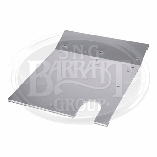

If it is a seal problem you will find the brake fluid will be grey or black when you bleed as the rubber disintegrates. There are also two separate brake circuits so if one fails the other should still work. I say again, the first test is to replace the fluid (£30 for 5L from Halfords) because if you start pulling things apart before diagnosing the issue you will not know where to look or if you have solved it.
Pedal to the floor without any loss of fluid and then returning to normal is extremely odd. It can only be what connects the pedal to the pads. Next would be to o/h the m/c. Servo would be the last thing to overhaul. Incidentally do you have the servo heat shield C26500 that was installed on all 4.2's from around 1965? Servo overheating can cause problems and Jaguar recommended reftrofitting it to earlier cars. SNGB sell them: https://www.sngbarratt.com/uk/#!/Englis ... 761b61f154
Fosseway sell one if you can't get the original style: http://www.fossewayperformance.co.uk/servo-heat-shield/
