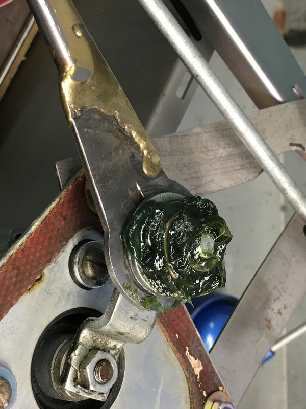

#23 Re: Wiper Drive Pimary Link, Eccentric, and Wiper Parking.
Post by Robbiee » Wed Jan 08, 2020 9:36 pm
Would this help?

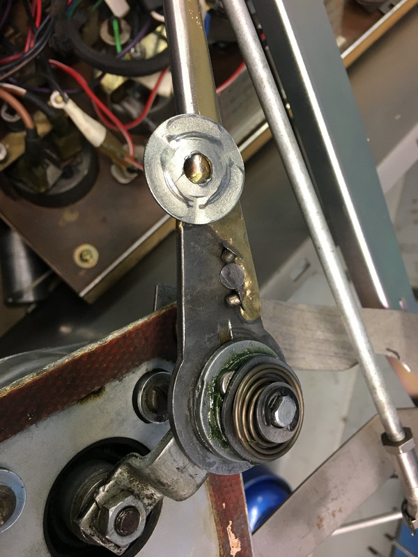

Posts: 356
Location: Derbyshire
#24 Re: Wiper Drive Pimary Link, Eccentric, and Wiper Parking.
Post by Robbiee » Wed Jan 08, 2020 9:41 pm
There’s a little washer between the spring and lever here

#33 Re: Wiper Drive Pimary Link, Eccentric, and Wiper Parking.
Post by rfs1957 » Mon Feb 17, 2020 6:13 pm
Couple of details that might help someone.
The three blips on the eccentric, that rumble along underneath the crinkly swash-plate, are necessary to creat the drag required to get the eccentric to flip one way or the other according to the direction of motor rotation.
These bits wear out, as does the swash-plate, see my earlier picture
particularly where its flats get chewed away - amazingly, the three blips are just a push-in fit, and I'm ashamed to say I made new ones from stainless self-tappers that work perfectly. The swash-plate is available from RM+J Smith, as is the cover to keep the indispensable grease in place.
