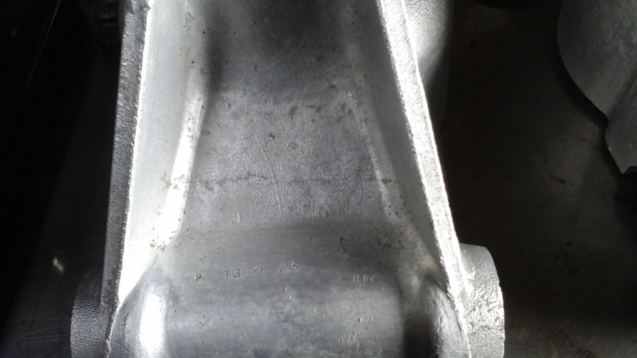

Hi Tadek...just for info.....its not uncommon for these carriers to have cracks.....when you get these second hand they are covered in dirt/grease etc and still have the old bearings in...the first pair i purchased after cleaning and removeing the old races were found to have cracks.....fortunatly i got them from a well known used Jag parts supplier who sent me more.......i found that once cleaned up it you brush petrol over them it will highlight cracks they can be anywhere like this one
