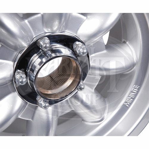

Hi Steve,
I've had a look at your build thread on Replijag, it looks really impressive. I like the attention to detail especially.
As regards the space saver, another option I thought of would be to use something like the splined centre hub from a Minilite to attach a modern slim space saver wheel. Admittedly you would still have the problem of storing the flat.

Post by mgcjag » Mon Feb 17, 2020 4:41 pm
Hi Simon..I like that center piece...my build thread is mainly there to help others who are building Realm replicas...unfortunatly there are a few useing it but not adding content of their own...so iv stopped posting for a while till they start to chip in.....Steve
