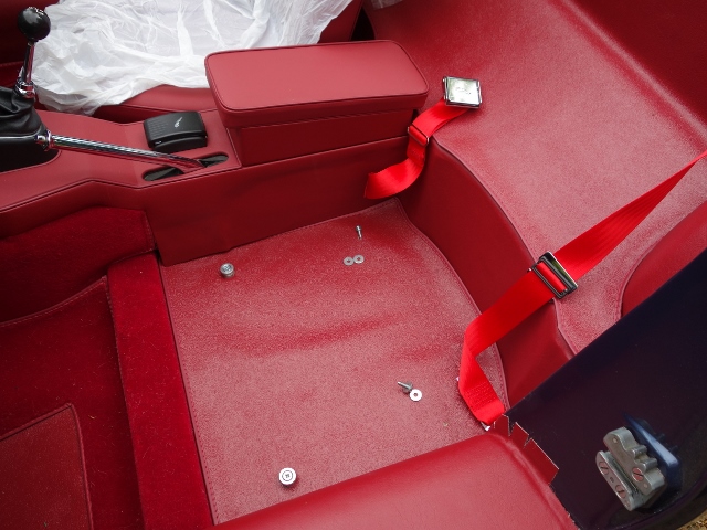

Does anyone have a picture of exactly how the front seat runner is attached to the floor on an S2?

#4 Re: Picture of seat runner attatched to floor
Post by 288gto » Sat May 23, 2020 8:16 pm
Hi Peter,
With the runners attached to the seat frames, the mushrooms are fitted to the floor as pic 1 and then the notches as pic 2 in the front of the runners slot into them. The backs of the runners are then bolted to the floor.

#5 Re: Picture of seat runner attatched to floor
Post by Pex » Sun May 24, 2020 5:45 am
Ahh, now I see how the sliders are fixed to the front knobs.
Thanks very much, exactly what I needed.

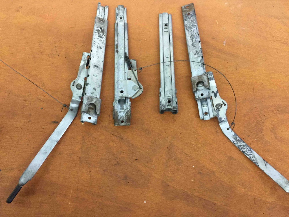

This probably not an original setup of seat runners, that's why I needed a picture.
The seat is original but the rest is not. So what is my best option, is theer any complete kit to buy or do I have to order everything separately?
//Peter
1969 Serie 2 OTS

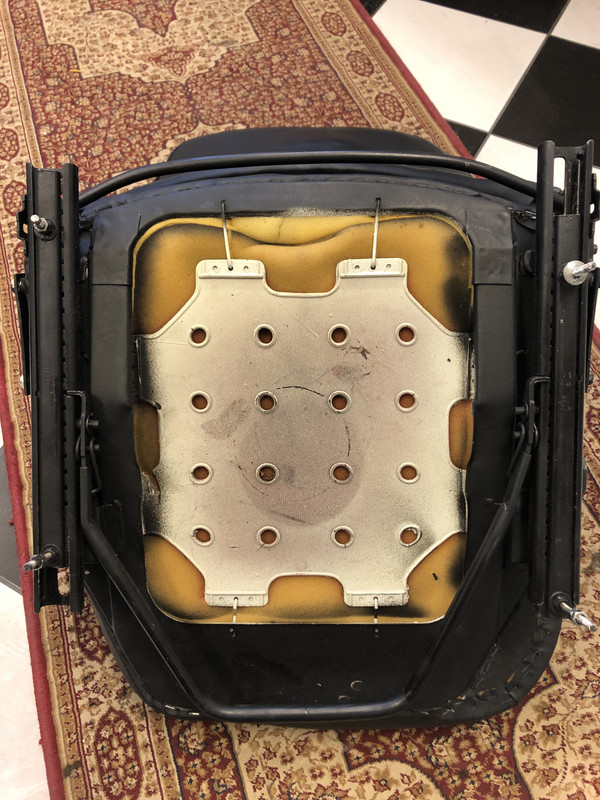

#7 Re: Picture of seat runner attatched to floor
Post by Pex » Sun May 24, 2020 8:28 am

#8 Re: Picture of seat runner attatched to floor
Post by Tom W » Sun May 24, 2020 8:45 am
Are they series 3 or 2+2 seats? The tilt mechanism doesn’t look like that on my car.

#10 Re: Picture of seat runner attatched to floor
Post by Tom W » Sun May 24, 2020 10:05 am
They definitely look like E-type seats, it’s just the lever for tilting the seat is different. It’s a rod with a moulded plastic end, not a formed plate. If they’re the wrong seats, it might explain why the runners aren’t the correct ones. I’ll take a photo later.

Posts: 6046
#13 Re: Picture of seat runner attatched to floor
Post by mgcjag » Sun May 24, 2020 4:02 pm
The seat adjuster changed at some point from the flat black lever as in Peters photo to the chrome as in Toms photo.....the seat runners look to me like S3 runners.....note the runner adjuster lever bar across the front of the seat connected to both runners........runners are available from suppliers or you might want to post in the wanted section....or adapt what you have....Steve
