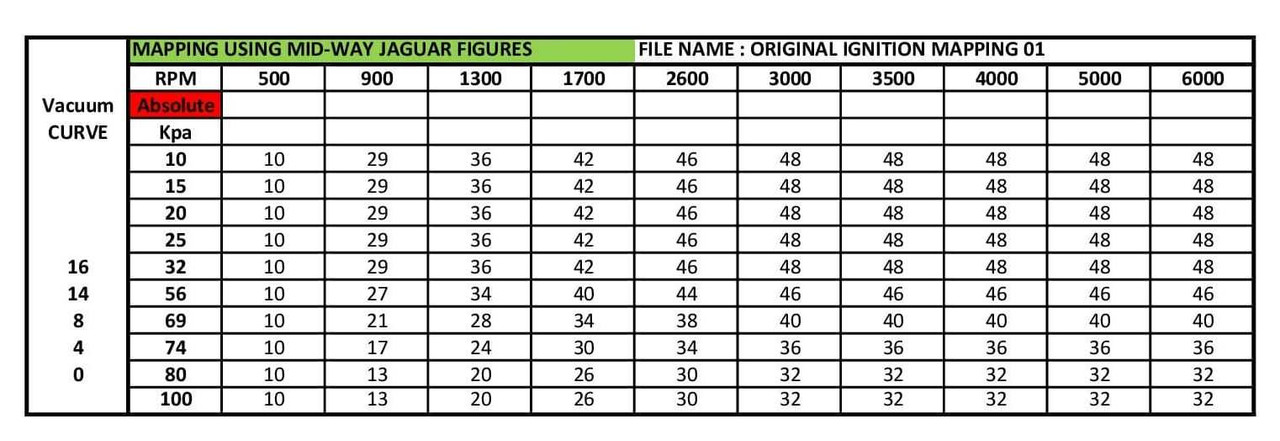

#102 Re: pre-programmed curves on 123 ignition - help please?
Hi Steve and Tom,
Firstly, yes the TDC mark is correct. It has been check more than once with a dial gauge. The engine is correctly set statically at 10 BTDC. I used the timing gun and it produced the numbers I came up with. I took the car for a short drive on the flat and up and down a hill. It felt harsh, but did not Pink. But the car is quite loud.
I never took the car above 4,000 rpm both with the gun and on the road as I could see and hear it was not right.
I think this comes back to a comment I made before that the 123 vacuum is a switch not a proper vacuum??
I then went back to the generic standard preprogrammed vacuum setting that has a maximum of 10 degrees.
I also used the Distributor Doctor curve from MarkRado post in a previous set of posts, that has 19 at 3000 and 22.5 at 4000, plus my static of 10 BTDC.
The car drove much the same, but not as harsh and I think pulled slightly better up hill.
As I said before the test, I used Chris’s highest vacuum numbers, plus the highest advance numbers.
Both of these from the Jaguar manual.
Yes, I agree my car is not a standard 3.8 E Type, but being modified, it is closer to that than a standard XK120.

#103 Re: pre-programmed curves on 123 ignition - help please?
Hello Chris, I think your post crossed with mine when I was typing it.
When I raised the revs to 3000 I never realised I was meant to see such a high advance number, as your post saying over 50 degrees. I just saw a much higher than anticipated constant advance degree and backed off.
Yes, I was doing it with the vacuum connected.
So, tomorrow I will go back re-enter the curves I set out in my previous post, try with and without vacuum to see if I get your numbers. As I said on the previous post, I was using your second set of higher vacuum figures and also the highest ignition advance from the Jaguar manual figures. I think I am right in saying the 3.8 can take higher advance than 4.2, thus assuming 3.4 can take even more. Although I am told higher compression should take less advance ??
Did you agree the two curves, looked ok ?

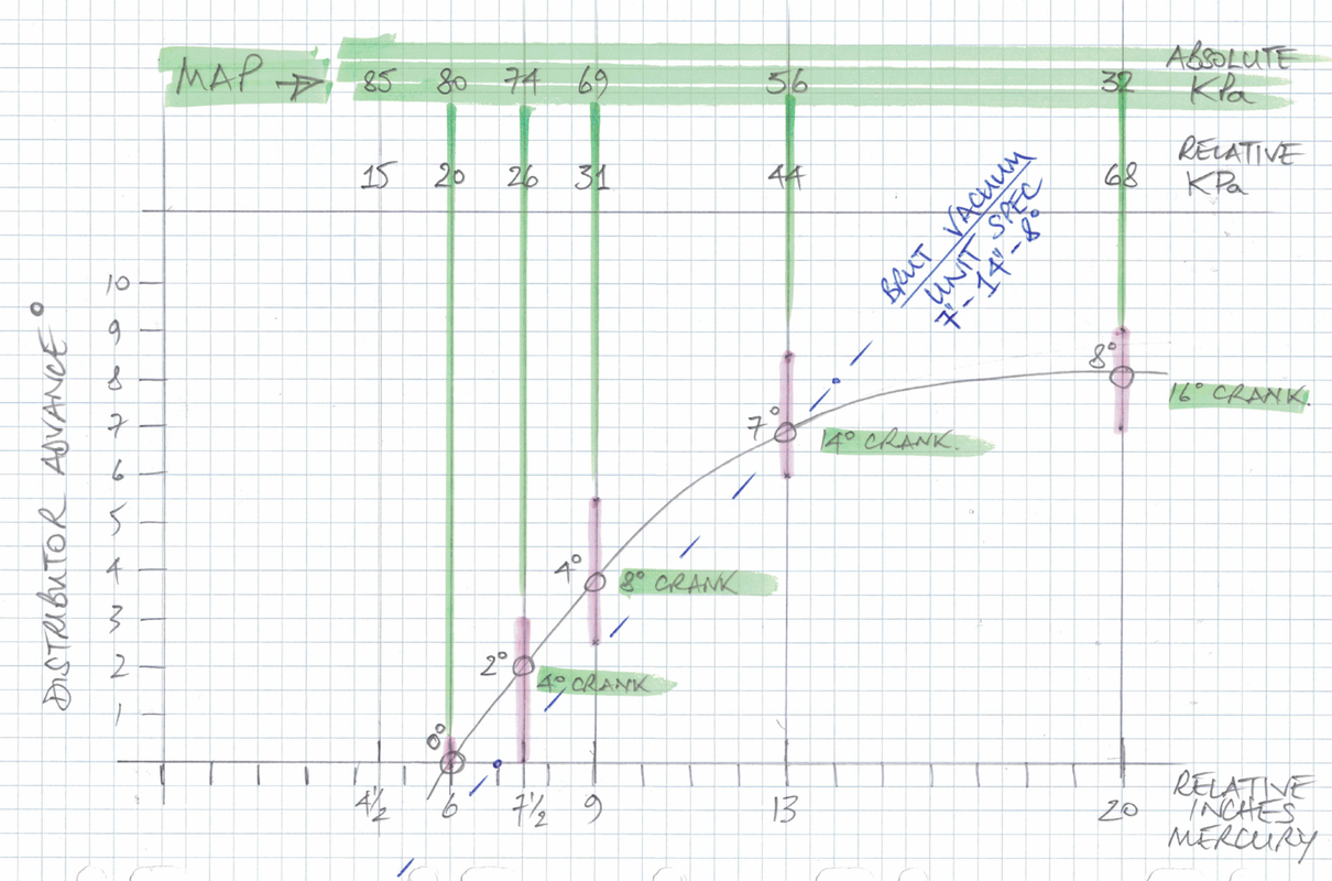

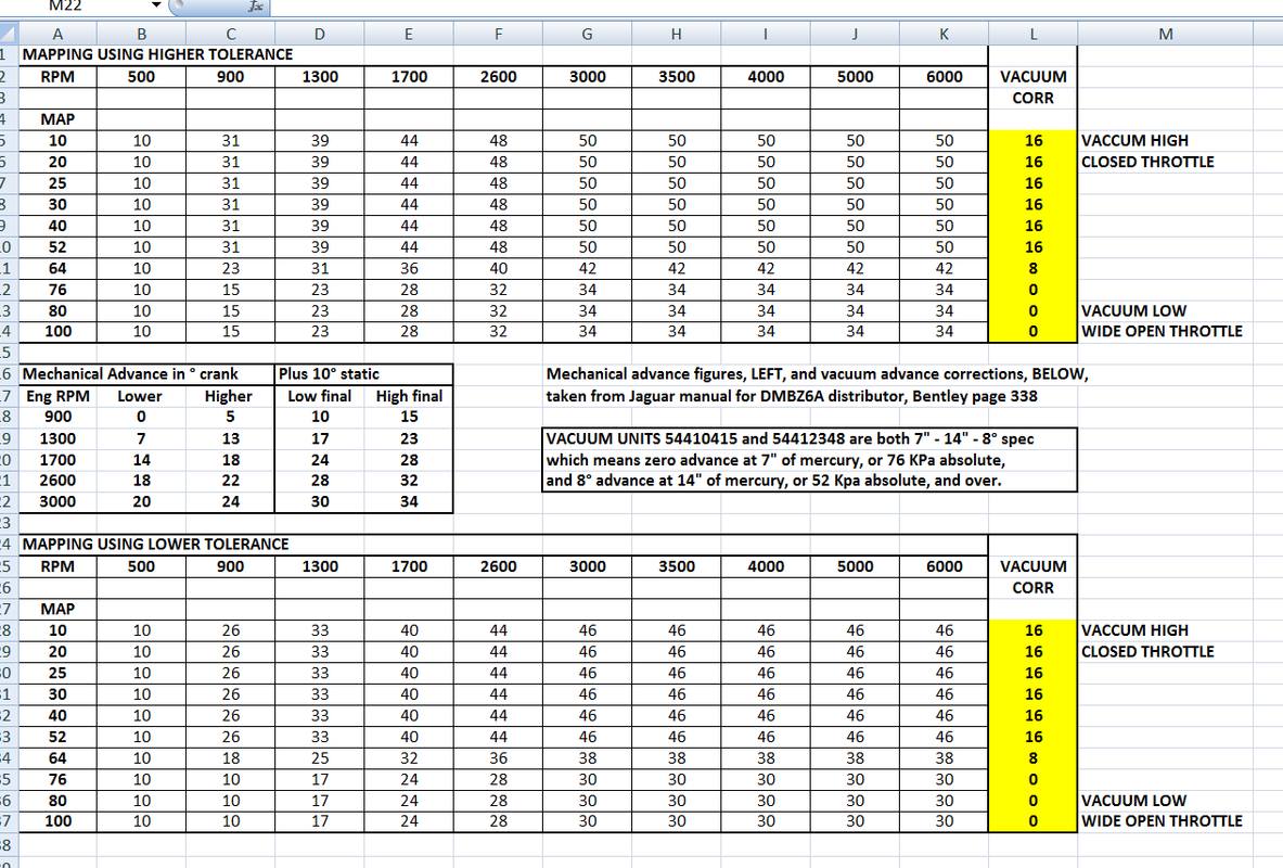

I'm not sure quite where to post this.
It stems from my wanting to make a map for the MegaJolt that is as true a representation of the original 3.8 ignition as possible, reflecting the effects of both the centrifugal and the vacuum vacuum advance, as I haven't found anything that comes remotely close in the MegaJolt section.
However, the 123 ignition is a not dissimilar platform, and as some of the debate on this string has covered the topic of vaccum advance, I'm going to put it here, and add a link to this on the MegaJolt page.
This is the reasoning I followed ............
The Jag advance curve specifications (p.338 Bentley) for the DMBZ6A distributor (and others) are given in relation to manifold vacuum expressed in inches of mercury.
Higher suck (the higher mercury figure, equals closed throttle) produces a higher advance figure, whilst wide-open throttle (WOT) produces the lower mercury figure, which produces a lower advance.
So far so good.
However, the Jaguar figures are not absolute pressures as understood by a MAP sensor, but relative ones.
The Jaguar vacuum advance operates linearly across a range between 7" and 14" of relative mercury, which corresponds to 24 KPa (WOT) and 48 KPa (closed throttle).
These are absolute values.
Critically, as the MAP sensors used in the MegaJolt and the 123 consider 100 KPa to be the "zero condition", atmospheric, the range of operation of the vacuum advance therefore corresponds to MAP readings NOT of 24 KPa, but 76 KPa (100 - 24) at WOT, and NOT 48 KPa, but 52 KPa (100 - 48) at closed throttle.
Quite counter-intuitively, then, the MegaJolt and 123 map vacuum values, and break-points, are absolutely not comparable with the Jaguar values, because their numerical variations occur in diametrically opposed directions.
A MAP sensor applies a HIGHER advance figure when confronted with the SMALLER number, which it sees at closed-throttle, and applies a LOWER advance when confronted with a HIGHER number, which it sees at WOT.
The maximum advance correction (16° crank) is therefore to be applied for MAP values of up to 52KPa, and then diminishes to zero for MAP values of 76KPa and over.
I think this takes a bit of getting one's head around, but anyone trying to recreate original advance maps needs to understand these nuances.
For my money, the original 3.8 ignition looked like this - the HIGHER TOLERANCE and LOWER TOLERANCE reflect the circa 4° tolerances that Jaguar specified in the centrifugal advance, so the actual ignition probably wandered around a bit in the middle.
I've cancelled the effect of manifold vacuum for the 500 rpm bins as originally the vacuum advance was fed from ported manifold pressure, and so would have seen no suck with butterflies shut.
Please feel free to wade in and correct my calculations and reasoning, and there may be better ways of explaining this !

#108 Re: pre-programmed curves on 123 ignition - help please?
Here's an updated file with the suck parameters in both "Hg and KPa.

#109 Re: pre-programmed curves on 123 ignition - help please?
Great work Rory...thanks for posting......should clear up a lot of programing issues for 123 users....Steve

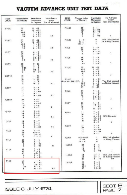

With help from the irrepressible and helpful Rob at BritishVacuumUnit.com
https://www.britishvacuumunit.com/ (they also do distributor rebuilds)
I now have this extract from a Lucas book that confirms the same figures, reassuringly, that Jaguar specified in period.
Rob said, and I quote
The graph and some spec information show the curve and some show the range.
Both units 54410415 and the later replacement 54412348 are the same code.
In real life the Lucas test sheet may be the 7 hg can have a start test range of 6 to 8, full advance @ 14 hg may be 13 to 16 and the degrees may be 7 to 9.
When I build a unit I try to get them exact to the spec usually much closer than when they were new from Lucas.
If you're talking about the early XKE with the DMBZ6 40617 distributor, The XKE and XK150 cars were supplied when new at the dealer with the 54410415 early Hex type unit.
I have a 1962 CVA Lucas replacement parts book that has the 54412348 as the replacement unit. That was when they changed production to the cheaper cup chamber with the small threaded line fitting.
Remember or note that in real life all engine are not identical. If the cam timing, carb mixture, or exhaust etc is slightly off, it can change the vacuum that effects vacuum unit advance.
I've re-plotted that relative vacuum data, drawn a putative curve that satisfies all the conditions, and added the corresponding absolute vacuum points in green at the top
Based on all of that, this is what I now believe Jaguar - had they had a 123 or a MegaJolt - intended the advance behaviour to look like.
I am NOT suggesting that is what is best with today's petrol, but it is going to be my starting point.
Anyone like to check my advance figures ?

Hi Rory...figures look correct to me......so you have actually taken the approx mid point range of figures as shown for vacume in the distributor section of the Jag service manual........One point to note for anyone programing a 123 is that all info Rory has given is related to a 3.8 with DMBZ6A dizzy........however if you have a 4.2 that used a 22D6 dizzy the vacume figures shown in the service manual are exactly the same as the DMBZ...but the centrifugal advance is different......so just re calculate useing 22D6 centrifugal figures.......Steve
#112 Re: pre-programmed curves on 123 ignition - help please?
Yes, I just tried to plot a credible curve that lay within the vacuum spec boundaries.
I'm still not happy with the point at which I'm exposing the advance to the vacuum effect though.
Originally (just been testing with a vacuum gauge) the ported-vacuum only starts to read at all at around 1700 rpm, and is only at 5" of suck by 2000 rpm.
Whereas the absolute manifold vacuum at that point is at about 30 KPa, which is 20" of relative suck.
So the position of the ported take-off, right next to the butterflies, makes for completely different behaviour.
Difficult to know how and at what point to tie the two, ported and manifold, together.
Currently my map gives 24° of advance at 900rpm - the engine is sweet as a nut, but that wasn't what Jaguar had intended, it should be about 13°.
So a bit stumped right now.
EDIT - I think the question of ported vacuum as opposed to manifold vacuum has a far greater effect on the mapping than I've grasped until now, and puts mapping in this way into question ; so better considered Work In Progress. My apologies if I've given anyone sleepless nights. Will update when I've made more progress.
