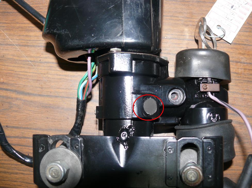

Hi Guys....thanks for the replies....this is a photo of a S2 steering lock houseing....what my mate has is this same thing but the ignition switch is on the right.....so can this houseing be turned....think its just held in with a sheer bolt....Geoff...are you talking about the large cross bracket on top.....do you cut this off and reposition to in fact turn the column over......instead of just turning the ali housring part..Thanks...Steve

Hi Steve, I hadn’t noticed the sheer bolt and was expecting to re-weld the brackets. It depends on how easy it’ll be to drill out the sheer bolt. But a precaution, the angle of the sheer bolt holes need to be checked carefully to make sure a simple rotation will align the lock nicely.
Must admit you’d hope it would

Hi Steve, no not yet which why my thoughts had been of cutting and welding. Looking at my column I couldn’t see how a bolt is threaded in, might be a tapered pin? If you look at your photo there doesn’t seem to be a thread but nor is there a taper
Sorry not to have the definite answer
PS, yes mine is similar to yours with the lock about 150 degrees rotated, not 180 degrees as the steering lock points slightly down from horizontal

Hi Geoff...from chatting to my mate he says on the top of the ali houseing on that slightly raised section it looks the same as the 2 sheer bolts holding the ignition lock to the houseing....

Just checked my lock and it looks like it is a taper pin, 10mm at that! The open hole you see in your lock housing photo is tapered and without drilling out the pin I can’t see where a bolt can thread into.
The lock has a thread to accept a shear bolt, I do think this is different, hence a taper pin is my suggestion

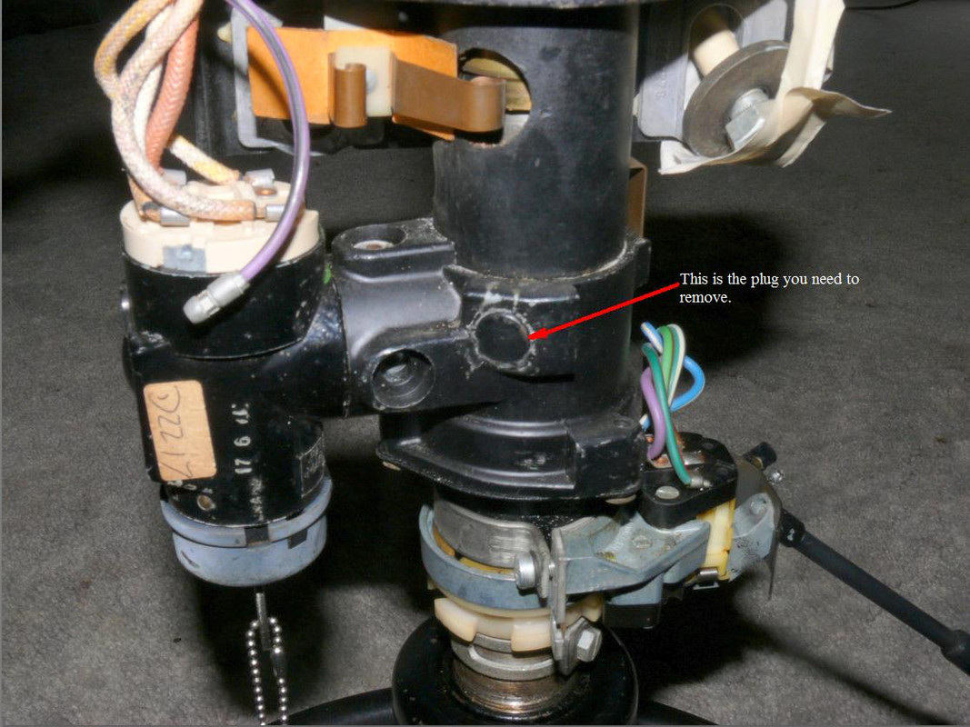

Late to the party, but of course, no cutting and welding required. The components of the Ignition Switch Housing/Steering Lock and the Steering Column are made ambidextrous.
The pictures used are of an S3 Steering Column, but the same applies for S2.
The following two pictures show the plug that needs to be drilled out (I have a fixture on a Machining Centre whereby the plug can be neatly machined away to nothing) and the corresponding bore that's used for the New Plug once the Steering Lock Housing is re-positioned.
The Steering Column Tube has corresponding holes for LHD and RHD Steering Lock Pin position. When re-positioning the Ignition/Steering Lock Housing, these holes are used to index the Housing to its new location. Not a clear picture, but see the following picture:
The diameter of the bore for the New Plug is the correct tapping size for M12. Tap this bore using an Intermediate and then a Bottoming Tap to the bottom of the bore. I've made a drill guide, that screws into this threaded bore, with a centre hole to guide a 5mm drill.
1. With the Ignition/Steering Lock Housing indexed to its new, RHD position using the Steering Lock Pin, drill a hole through the wall of the Steering Column Tube using the drill guide screwed into the New Location Pin bore.
2. A short M12 grub screw that has a short 5mm spigot machined on its end is screwed into the new location bore so that the spigot engages with the 5mm hole drilled in the Steering Column Hole, The length of the Grub Screw should be such that it's outer face is below the mouth of the bore into which its assembled. The Grub Screw is firmed up and Thread-Loc used to ensure it doesn't come loose.
3. I finish the job by sealing the bores with an Epoxy Resin to make the new plug Tamper Proof and so that the completed job looks neat and tidy and as an added step to ensure the Threaded Plug doesn't come undone. See the two following pictures:
