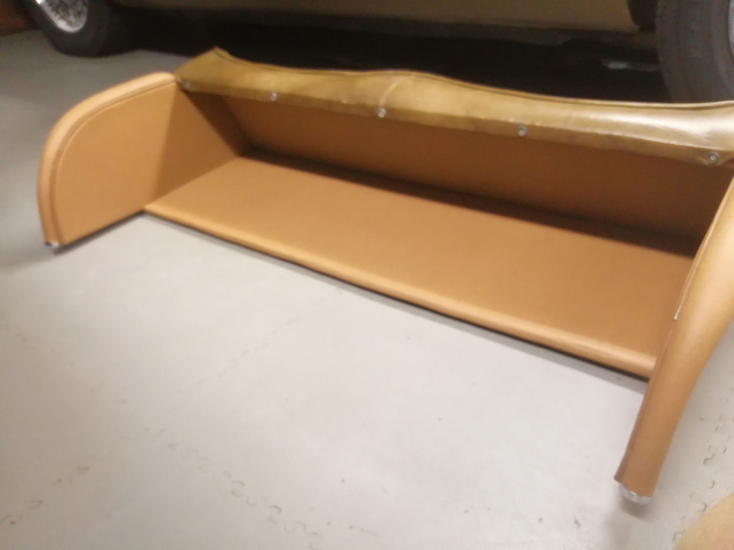

Did the boards in mine back in the summer. Used vinyl from BAS (very helpful company) over 2mm neoprene foam (from 'rubberandsponge.com'). Managed to keep the old plywood boards, but they needed a lot of glueing back together after delaminating and flattening.
Am very pleased with the results - didn't refit the luggage rails as 2 of the long ones were missing and haven't found original replacements - but don't really need them anyway.
