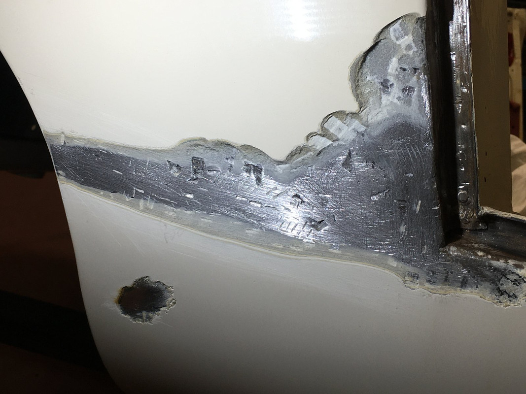

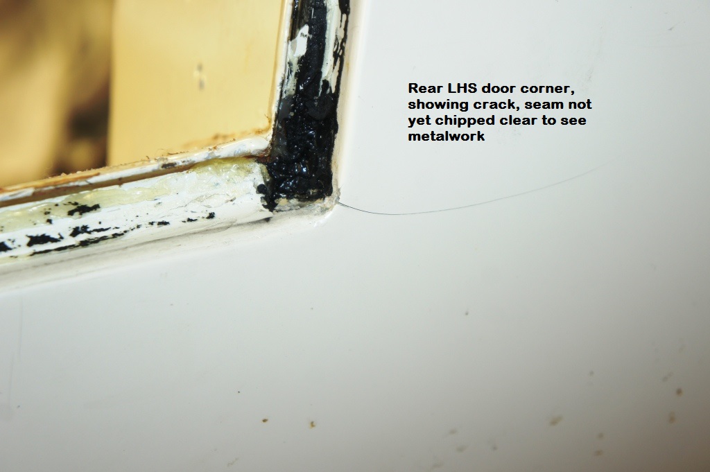

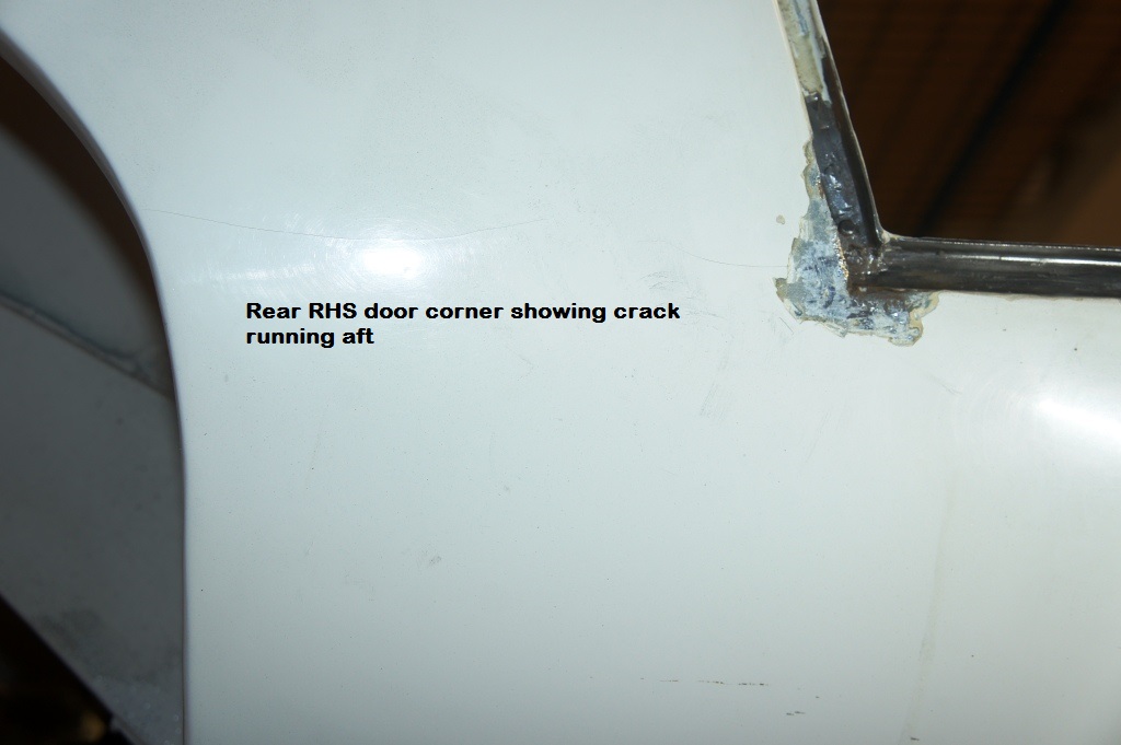

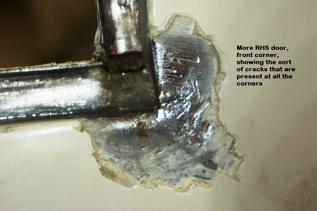

I took the car to bits three years ago mainly to address these issues, but have got side-tracked and now find that if I'd wanted MonoCoqueMetalWorks to accept my shell in a container I should have booked it in two years ago ........ and so it's going to be Made In France after all.
There's too much filler just about everywhere but it doesn't seem to be concealing any horrors.
The shell was rebuilt professionally nearly 30 years ago, including outer sills and a whole back-end, I have the pictures, and it's been wax-injected and warm/dry stored ever since, so I don't think it's a corrosion issue.
Indeed, I also had some cracking on other un-stressed areas that had received a skim of filler (doors, bonnet flanks) in the same period, and these turned out to be just poor surface preparation.
So I may just be looking at the same issue of surface preparation and/or filler type.
The lead-loading looks good, the gouge marks are attempts to test the filler's adhesion.
I'm wondering whether to ignore the temptation to melt the lead out of all the joints, and just re-do these areas with "better" and "more flexible" filler, as I've been told that this was an issue even in period due to the shell flexing.
Has anyone else had issues like these on an otherwise sound shell ?
What fillers should I be considering as suitable for this sort of application ?
If anyone has had a professional address these concerns on their shell, and I think I remember a thread that touched on this but can't find it, could you tell me who did yours ?

Could this be partially due to flex in the shell at these points, especially given that it is an OTS. I know Hutsons use an extra inner sill strengthener and Chuck uses his own internal ladder frame set up. You know me Rory, I used both. But I'm special :lol: :wink:
Also probably not what you want to hear but certainly in terms of the sills having been replaced(?), what was the quality of the welding?
Have you spoken to Angus? I'm sure he's encountered this before.
Gratuitous pic of inside my sills......
The stiffener is from Hutsons but a man of your skill could easily make one. I seam welded it to the A and B post strengtheners and put drain hole in the bottom of all 3 parts. More pics available if you need them.
As regards filler, I used Upol D on the recommendation of Andy at Hutsons and subsequently endorsed by the body shop. Again ask Angus, he's the man in the know.

Sadly not what you wanted to hear, but your car flexes around this point. You can see the crack goes straight through the lead loading. To do that, the lead has to be firmly attached to the steel on either side and then worked continuously along the gap - it then cracks at the edge and then propagates over time.
Upol is what I used on my car.

I would remove the lead if it were me; it doesn’t look good to me and could be hiding a poor repair.

I think, Rory, that the problem is that the lead creeps over time under the influence of gravity ( as does, believe it or not, glass ) and this in itself sets up stresses in the lead which then cracks . My OTS has done the same thing . If you reheat and repair the lead I doubt whether it will happen again in anyone on this board's lifetime ! :bigrin: :sad: :cry:
PS it is certainly not something worth worrying about, and does not suggest that there is anything abnormal about the bodyshell on your car

Cracking like that is a sure sign that there is unwanted flexing in that area
You need to find out why
Its broken through the lead loading as well
The sills on an ots are the only thing that keeps the front and back parts of the vehicle together and give it rigidity
If it was me and to be fair I don't have all the facts obviously, but I would suspect something hasn't been put back correctly
Or there is a structural integrity problem somewhere else
Would be great to see what's going on in those sills
Oh and I have never heard of lead loading move over time like glass
Old wives tale
Just my thoughts

I was brought up to use only aluminium reinforced body filler on metal panels/parts as it is more flexible, less absorbent and gives a metalic finish when correctly wet & dry rubbed (Technical term we used was 'knocked down') and dries/sets harder than polyester filler, it is more expensive but so much more worth it .. The only time to use polyester filler is when your using it on GRP. Make sure the surface is clean and free from oxodisation before application.
Edit: Leading is easy, do NOT have your flame fierce, use plenty of tallow and have a selection of wood floats to hand.

I'm surprised at the amount (thickness) of filler, which is surprising for car with apparently proper leaded joints. I suspect there may in fact be surprises lurking below as there really is no need for filler to 'contour' the body on an E if lead is used. Just a wee bit here and there to even the surface.

The third picture down of the B post and bottom of the rear wing seems to have a curve to it; the filler is thicker by the door post than at the wheel arch. Also the last picture looks like very crumbly lead.
In my opinion this leading does not look good. Leading is relatively easy to do (except on flat panels) and is much more resistant to flexing than filler and it can even be raised or lowered by panel beating with no risk of becoming detached.
The outer sill is welded to the inner sill in these areas and also to the A and B posts + the rear wing and panel between the door and bonnet, so little flexing should occur.
I would be checking the welding under that lead.
