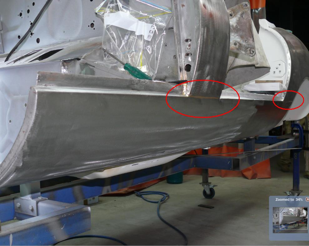

Hi Rory,

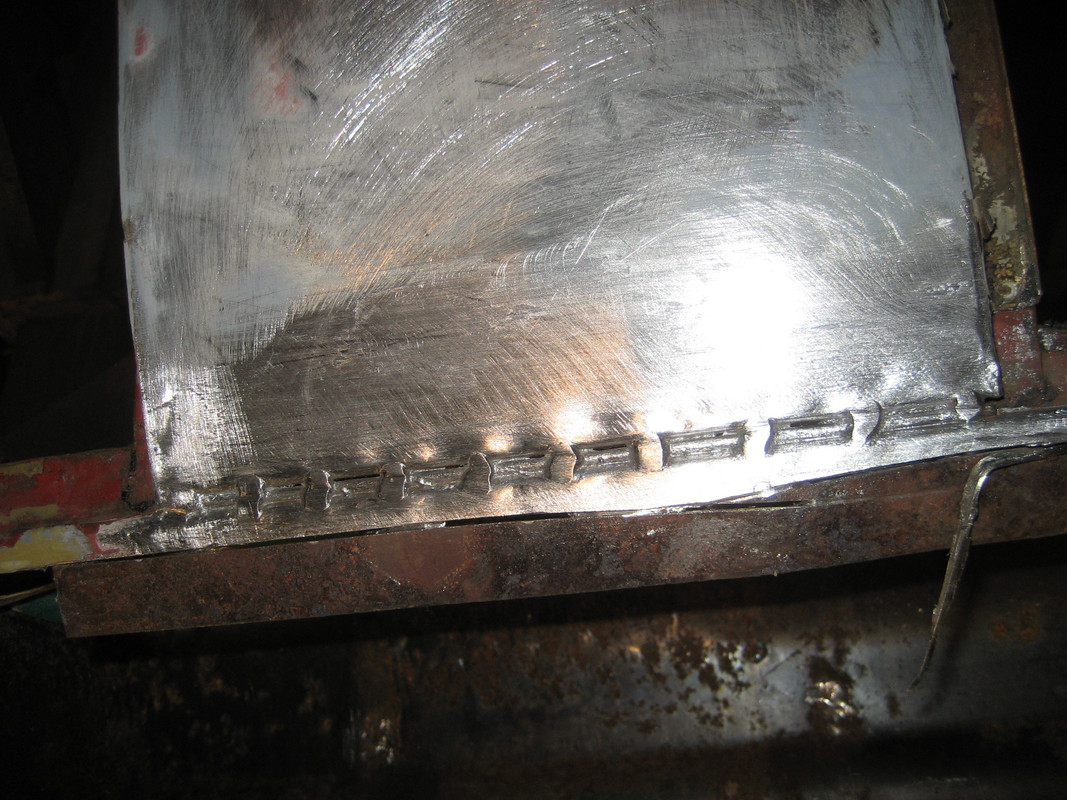

This is a problem I suffered at all 4 joint locations on my car and it was due to the fact the restorer had not welded the bottom of the wing to the top of the sill. No weld at all and all 4 sites cracked after I used a jack under 1 sill at the jacking point (testing a BMW jack for roadside flat tyre removal efficacy!!).
I took it to RVR in Kettering for correction. They removed all the filler and seam welded it and repainted. They did a marvellous job of matching the paint. Whilst I was there discussing the work I was shown an original, so far unrestored E-type shell which had been stripped of paint and lead so this displayed the factory work at this joint which comprised a stitch weld (about 1/4") every inch or so along the joint.
I would suggest if yours is only leaded along there and not welded at all, it will crack again, only question being, when?

"I was shown an original, so far unrestored E-type shell which had been stripped of paint and lead so this displayed the factory work at this joint which comprised a stitch weld (about 1/4") every inch or so along the joint"
the sill is spot welded to the A and B post inside too:

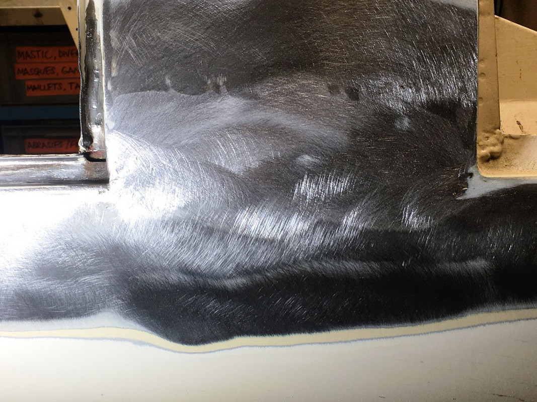

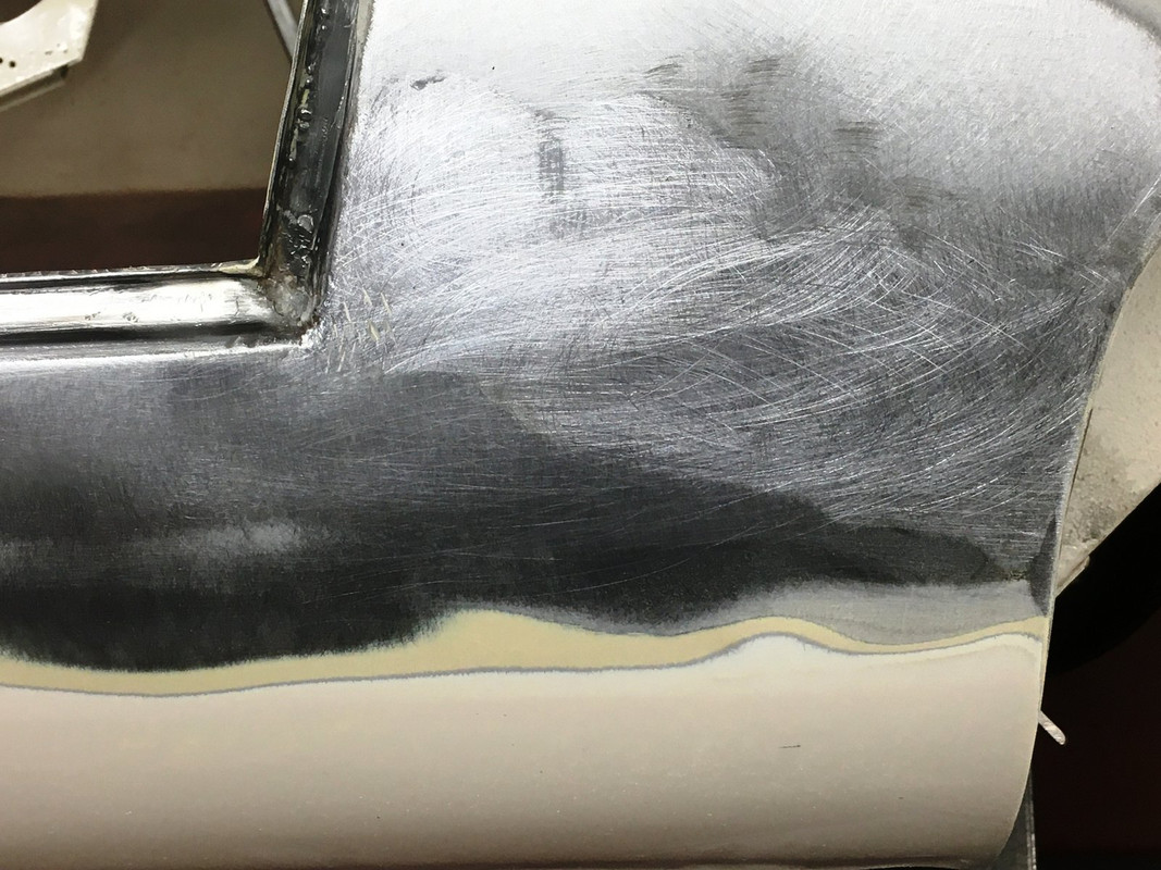

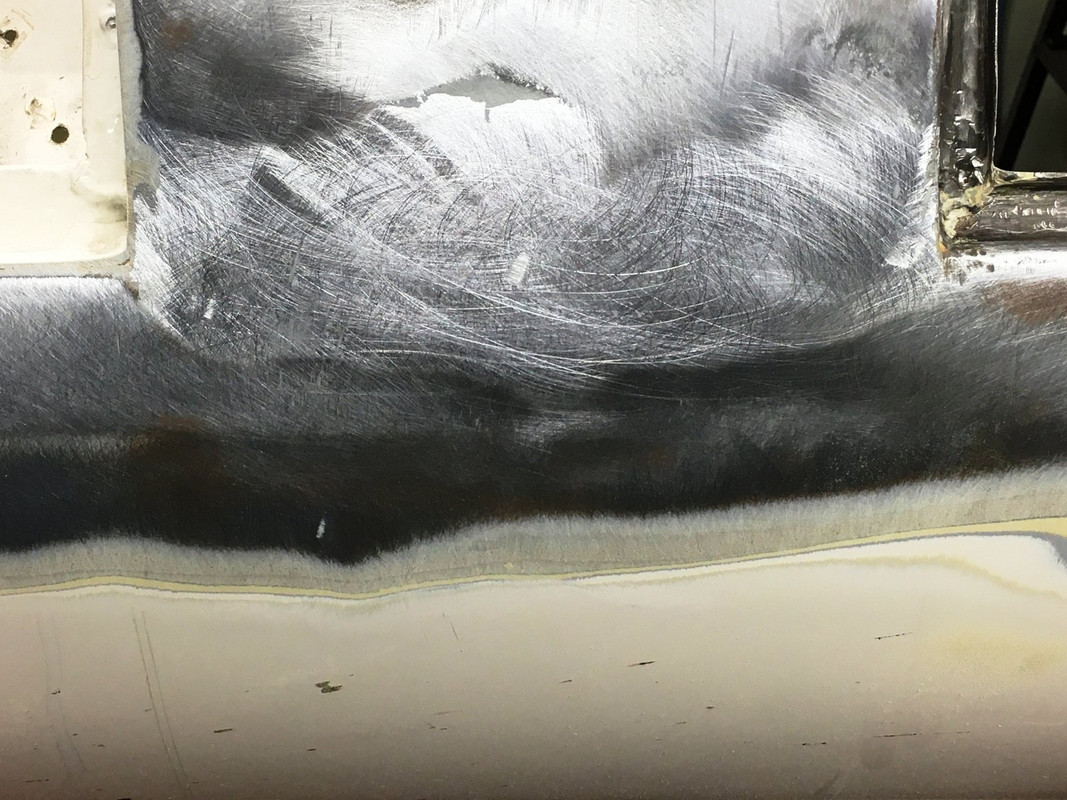

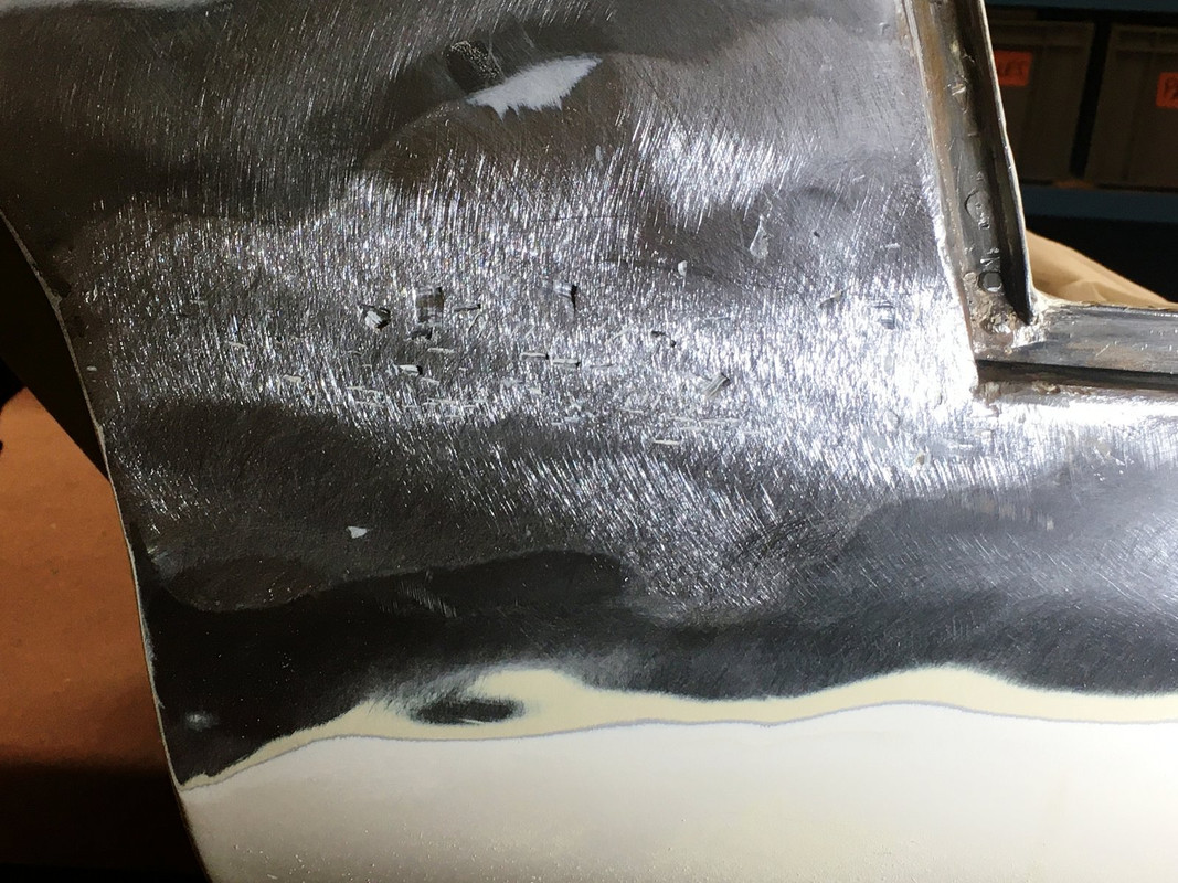

Decided to bite the bullet and get sanding.
Tons of unnecessary filler in an even loading over the whole bloody car, it appears.

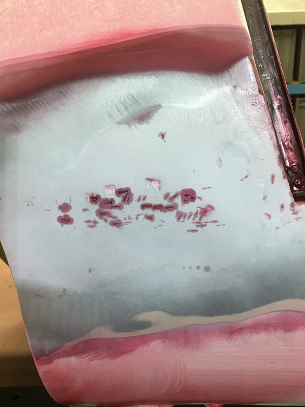

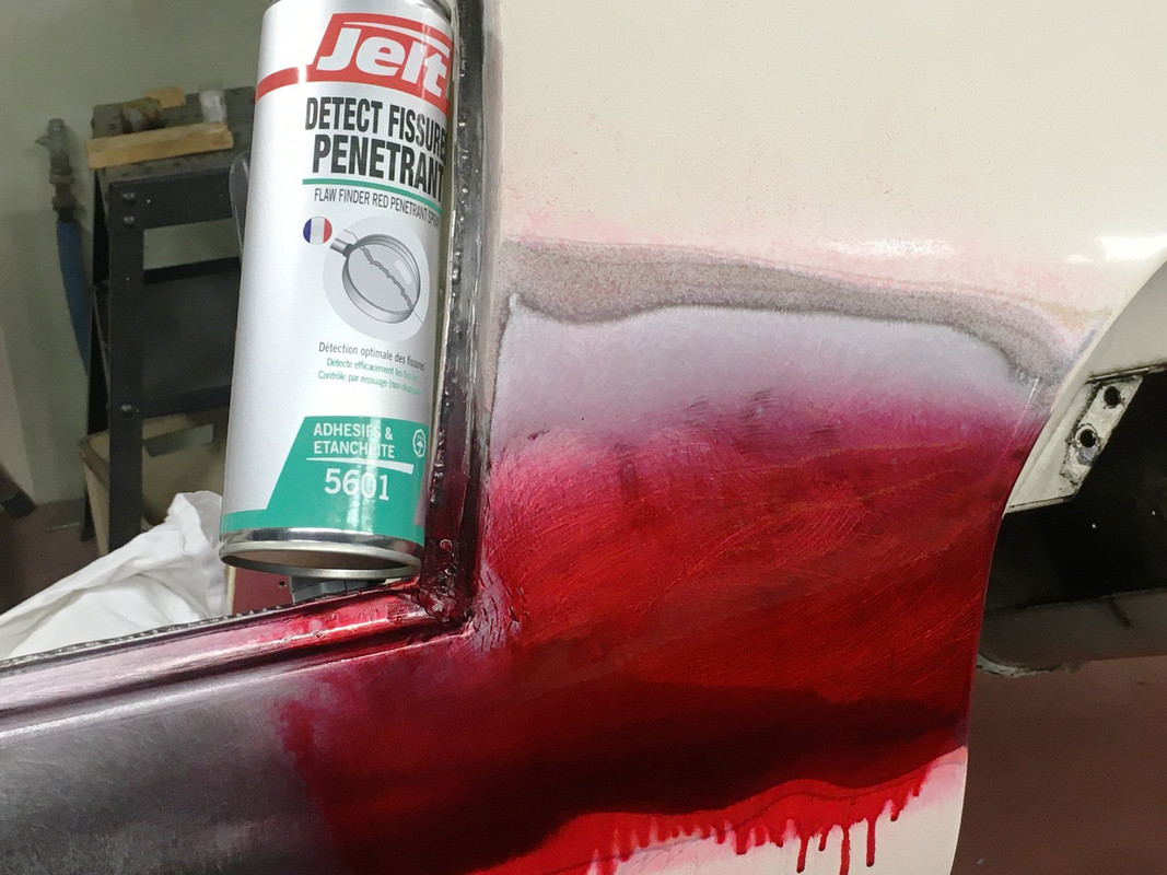

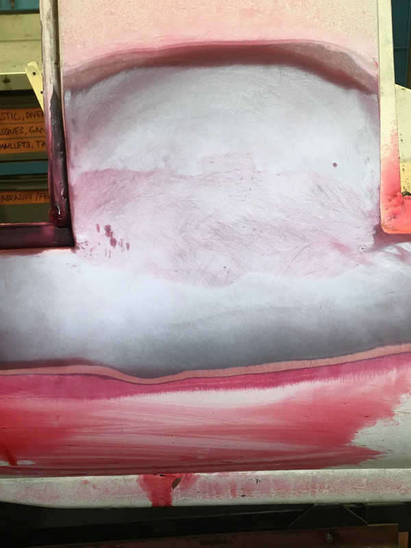

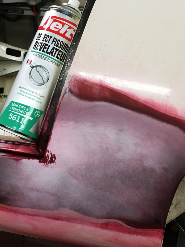

Crack detection penetrating spray (looks like a very convincing road-accident).
Clear differentiation between lead-loading and steel panelwork, but apart from my chisel marks from trying to probe for flaws in the filler, no sign whatsoever of any cracks.
Sighs of relief all around ?

Post by rfs1957 » Mon Dec 21, 2020 4:16 pm
There were various other completely unstressed areas on the car which, 25 years after the last work on the shell (when it had new sills, whole new rear end, and new bonnet), developed cracks in relatively shallow areas of filler (side flanks of the bonnet, door skins, all of which had been new at the time).
Upon investigation these all turned out to be due to poor initial adherence of the filler, which - anyway - once removed turned out to be unnecessary.
We wondered whether taking it south to experience our temperatures and our low humidity, both being something of a shock, wasn't partly responsible for these coming to light.
So I'm prepared to gamble that the cracks I've got at these corners is just the same problem, exacerbated by the fact that they're in areas of higher stress. Last time I had a bore-scope down the sills it all looked pretty good.
I may yet remove all the lead on one seam just to satisfy my curiosity.

The main reason for cracking in this area and where the sill joins the cowl, is that in the factory the joint was only tack, or stitch welded and then lead wiped. When I replace sill panels, or do any repairs at either of the areas mentioned, I TIG braze the full length of the joint, as shown in the attached picture, with no filler, either lead, or plastic used whatsoever.
