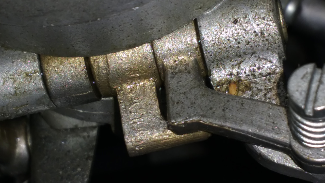

The choke on my 1966 Series 1 4.2 triple SU car drops the jet and enriches the mixture immediatly the choke slider is moved upwards.
Can anyone advise how I can reset it as per the manual, such that the first inch or so or upwards travel of the choke lever, only opens the throttle, and well before moving the jet?
Will I need to remove the carbs to make the adjustment?
Im trying to upload a couple of photos to show the arrangement, which clearly show that the jet lever is already in contact with the mixture adjustment screw arm when the car is cold.

As you state, the throttle plate should be opened as the first stage and mixture enrichment thereafter.
This is accomplished via the lever, cam, rod & shoe and arm mechanism on the shaft on the jet diaphragm housing. The primary lever, cam and secondary arm which actuates the jet diaphragm lever are fixed with tapered pins. The jet diaphragm lever floats on the shaft unpinned.
I would inspect all three jet housing mechanisms for proper operation.
You only have to remove the tapered pin on the arm which resides between the jet lever and the entire shaft assembly can be removed

#6 Re: Choke adjustment
Many thanks all for sharing your knowledge which I am now digesting.
In the meanwhile, Ive attached some photos that show the middle carb when the choke slider is off, ie at the bottom of the slider. The screw in the foreground is the mixture adjustment screw.
#7 Re: Choke adjustment
<t>Just to clarify my question, the mixture has been set with a Gunstons CO meter and is fine, and I have adjusted the slow idle screw (the big one) with an air meter and she ticks over steadily when warm.<br/>
So the only problem remaining is that the choke enriches the mixture immediately the dashbord slider is moved, rather than half way up, as is should be according to the manual. <br/>
The car usually starts first time and runs very well overall.</t>
