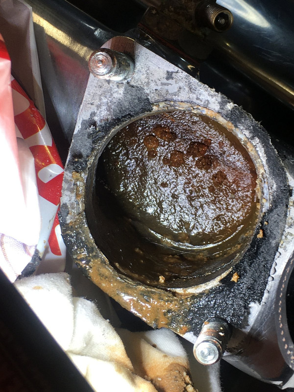

I can report (Ed - confirm the obvious) that filling a rebuilt engine, together with its painstakingly cleaned-out innards, with highly lime-rich calcarious South-Of-France water is not a good idea.
Quite how bad.
Now, I had only intended for this to be for a couple of weeks with the engine on the test-bed, after which I would drain everything, bit this turned out to be 6 months, during which I forgot my poison-pill .......
....... only to be rewarded with this.
That lot had looked brand new six months earlier.
From closer inspection I think there was something extremely galvanitic going on around the thermostat (brass of course) area, but - what an idiot.

Quite how bad.
